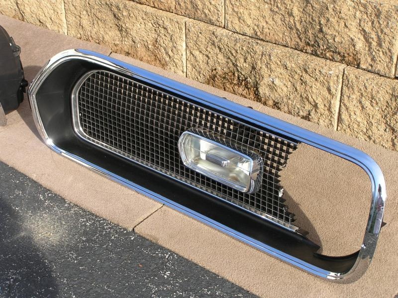

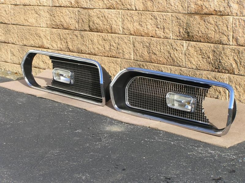

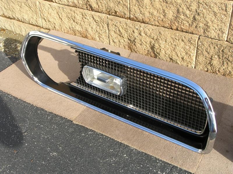

This is a NOS set, if you don't see what your looking for ask more questions. The thin trim around the egg crate is polished aluminum/clear anodized. The front edges of the egg crates are NOT painted black, they were sprayed from the back side, therefore the front edges didn't get paint on them.

The NOS ones pictured are correct.
so then the grille and the plastic molding that goes around is colored black like the one from the picture right?

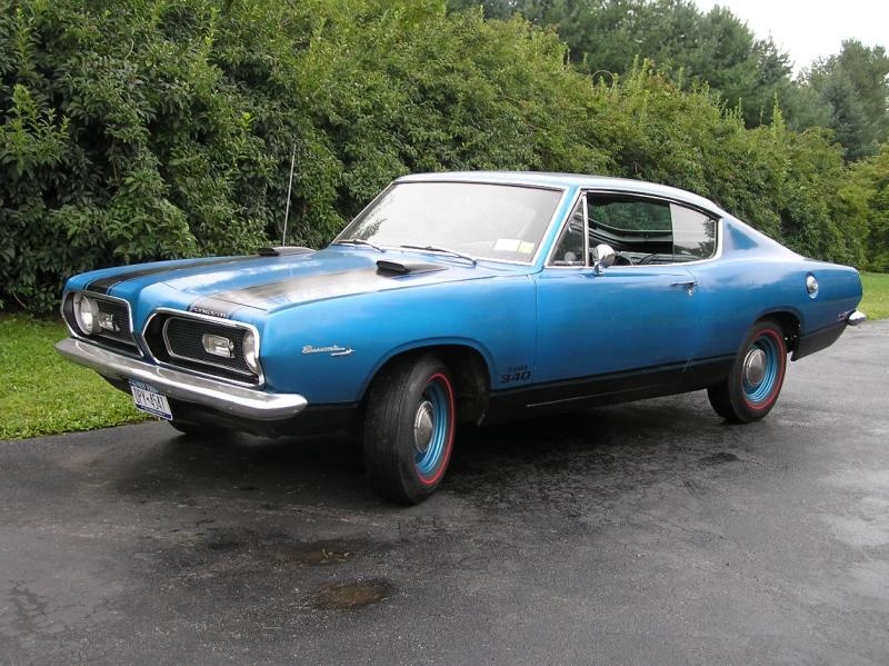

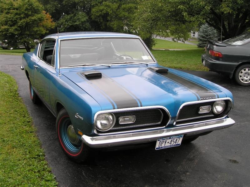

On this 340 i used(rattle can) satin black. If you look at the NOS set, even from the factory the right side is slightly glossier than the left!! This NOS set i would say is the black plastic, not painted. I was told by the guy that restored a set for me that the black sets came 3 ways from the factory, 1) black plastic, 2) black plastic painted black, for better matching, 3) light colored plastic painted black. Of coarse at the factory all the pieces would be separate and easy to paint.

Art, formula S and 'cuda use the same blacked out grills............The black plastic surrounds are reproduced now but i've never seen them in person and i don't know how good they are. The only place i've seen them is on Ebay, not sure who makes them.
