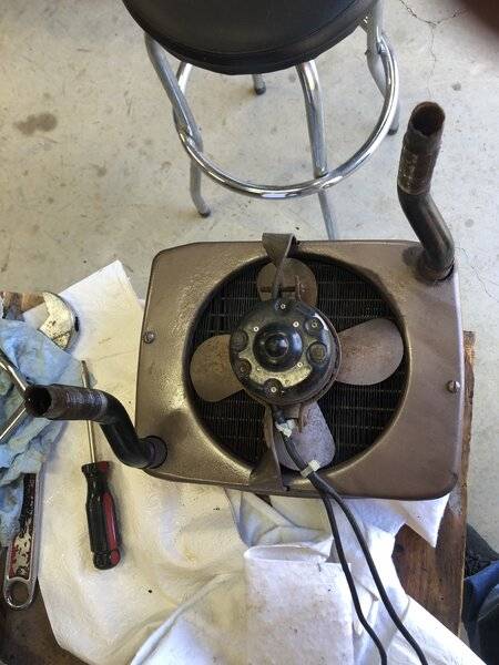

My 53 Dodge truck is mostly original. 6 volt positive ground. The 70 yr old aftermarket heater core is totally shot - rad shop can’t fix, and no aftermarket cores are close to the same.

The problems are where the water tubes are located, and they are shaped, threaded pipe threaded into the core also is threaded so that large nuts attach the heater to the firewall

The problems are where the water tubes are located, and they are shaped, threaded pipe threaded into the core also is threaded so that large nuts attach the heater to the firewallView attachment 1716350783
Thanks for the lead. I think I have checked it, but I wii go there. View attachment 1716350782
Contact Bob at Glen Ray Radiators. He will need some dimensions but I bet he can re-core that.
