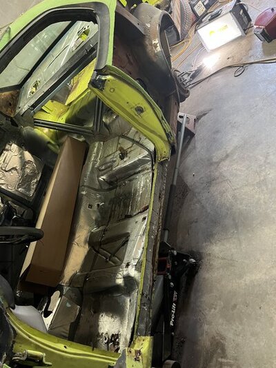

Hung out with the family this weekend, did talk to the body guy. I ordered a quarter and a rocker. The paint, and I got the 2.02 valves coming. Sounds like I can get in the machine shop this weekend. And the sandblaster said he’d be able to get me in after the first. Figured I’d better get back to work. We took the b by lower motor out, which was quite a deal. Pretty simple now. Windshield wipers and regulator. Misc stuff off the fire wall. And the windshield. Started on the rear windshield but didn’t want to press my luck or use it all up in one day. We’ll call it job security…..we’ll do it tomorrow :lol:
Popes the steering off to get the header out and found some questionable patch work in the corner of the rear glass, other then that and the blower motor went fairly well

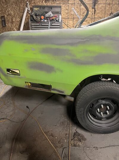

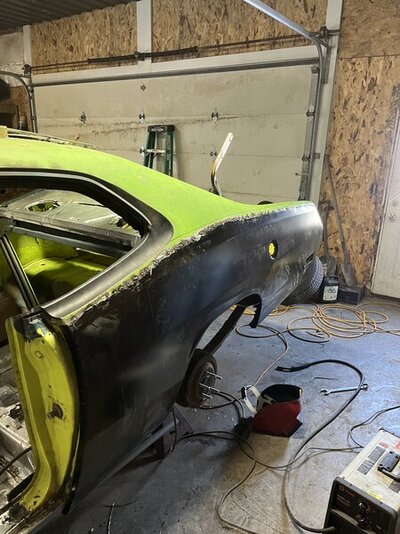

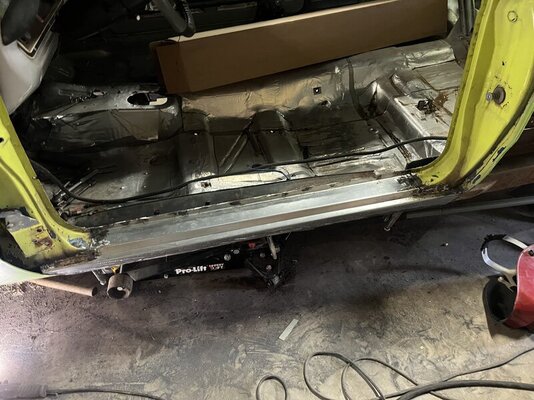

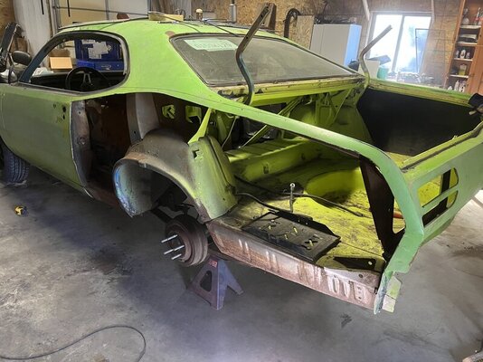

I’ve had to deal with more wood and snow and ice then I wanted to this winter. Ended up working on the road for a bit but found some time to work on the duster. Got the quarter and the rocker installed. Getting ready to do a patch on the other quarter and one on the drop off.

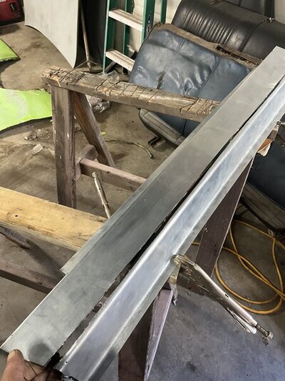

First time really doing body work. It took a while but getting it. Thanks to a lot f info on this sight. Had to cut and weld the rocker because that didn’t fit. But do to the hassle I wasn’t going to try to get another one.Got the valve stuff figured out. Ordered pistons, went with the kb 243-40. Should be around 10 10.25 to 1. Going to get the stuff back to the machine shop this weekend.
Got the patch done on the passenger quarter. Jades going to be working on the trunk lid, looks like some one had a Chevy style spoiler on it at one time and a bad primer job.

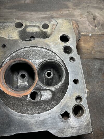

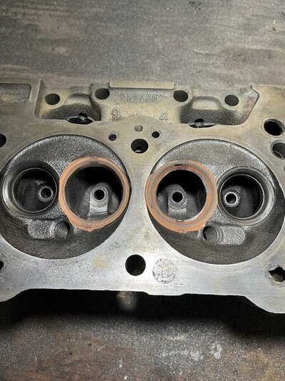

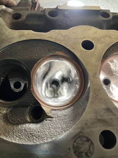

4CAADC37-96F0-446F-A4E8-0DB23FCCC1E5.jpegI opened up the bowls to about 89 percent, lended them in and took care of some casting marks. I laid the short turn back a little blending it to the new bowl. Took the valve guide down a little and smoothed it out. Not a professional job I still have to smooth things out and work on the exhaust some. Then gasket match and clean up the ports8733D96E-1FA8-447A-983A-DF023D803F96.jpeg

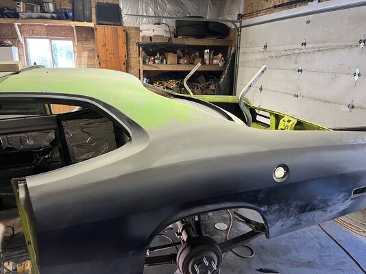

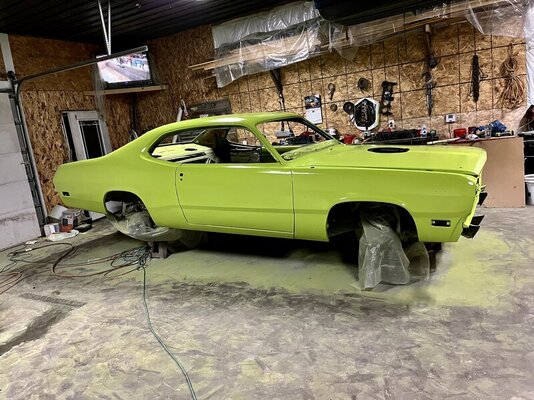

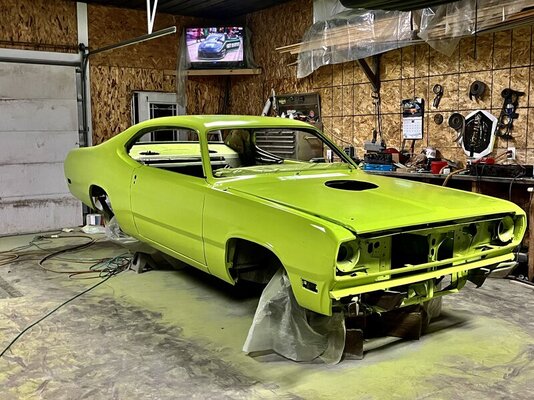

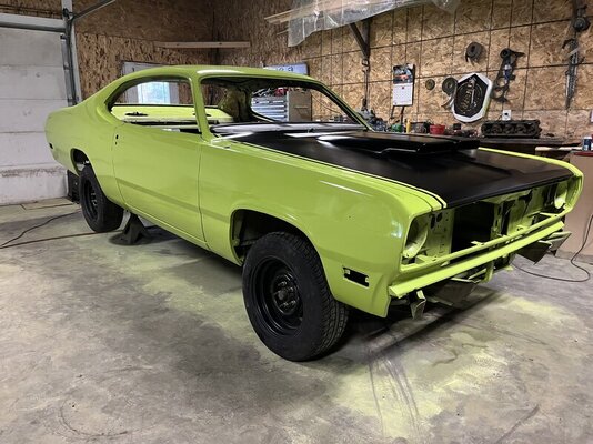

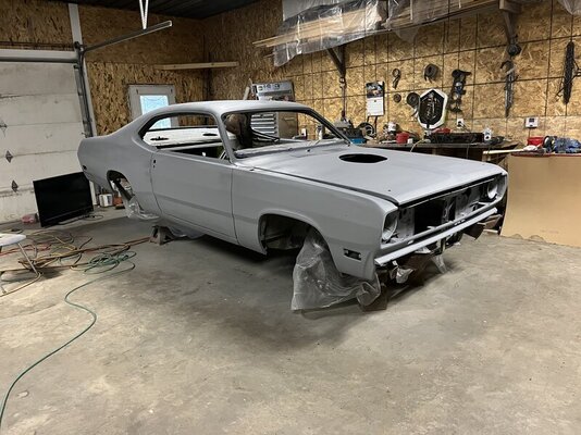

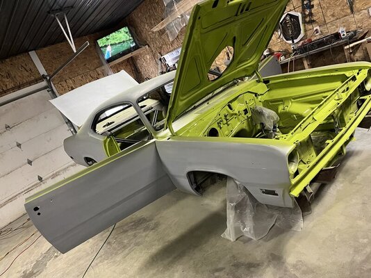

We worked on the duster for a while getting it sanded out. My girlfriend and my daughter were in the shop over Father’s Day weekend and I got it sprayed around forth of July. Feels good that it’s all one color

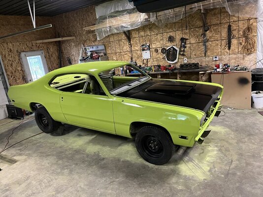

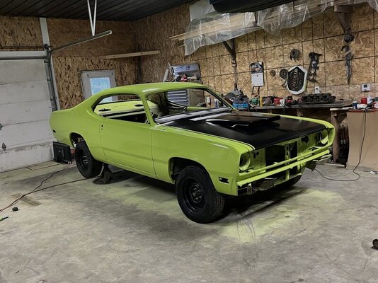

6F32D08A-F428-42CD-BC97-705F2852DCEF.jpegThe lines aren’t perfect and it had a couple dings yet, couple spots to buff out meybe. But all in all turned out pretty good. I did one coat on the hood to see what it would look like but going with the black still
