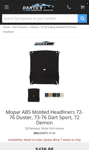

Hi all. I’ve read through a few threads on this but wanted to try to make absolutely sure if possible before I commit to this since they are made to order.
I want to try to the one piece headliner in my 71 Demon that had the bow type headliner before.
This says 72 Demon but does not mention the 71.
I can’t imagine the roofs are different between the two years but I suppose it’s possible.
Can anyone confirm for sure?
Also, this one from Dante’s looks the best I’ve seen so far. Anyone here tried one yet?
Thanks!

Thanks for the info! Is this what you mean? That’s one reason I was looking at the Dante’s one is that they offer sail panels covered in the same material as the headliner
