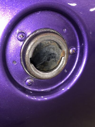

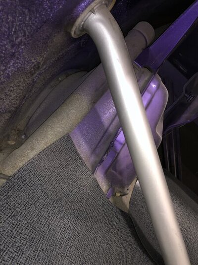

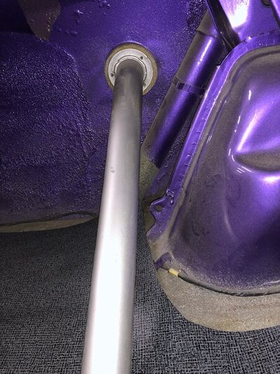

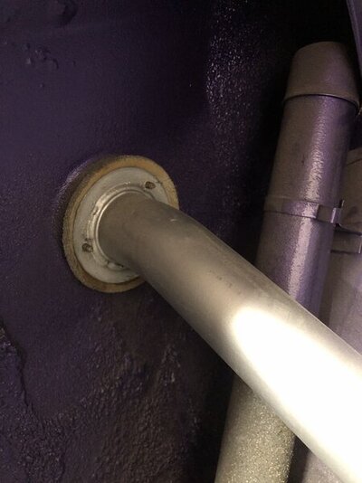

I'll post some pics later of what my setup is. Maybe you guys can help me make up my mind on which wrong cap to order again :rofl:
Fair enough?
From previous pics and this one, no additional tube. But looks like this has what looks like the beginning of emissions?

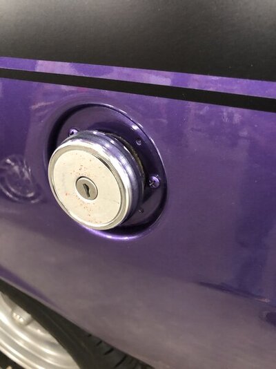

I'm running into the same dilemma. In the above pic the '71 cap is what I had back in the day before I left it on the trunk and drove off (1997). I have yet to find one that fits the same and locks in place when you turn it. Only ones that fit just keep spinning although they do get "snug" and that's when i quit turning it. Any luck on finding a good replacement that actually works??
