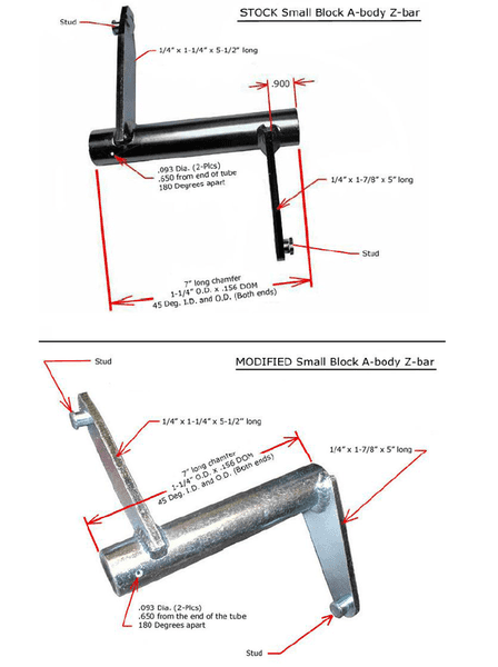

The TTI long tubes and the Doug's D453's both require this modification to the z-bar, or you have to buy TTI's Z bar.
