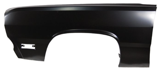

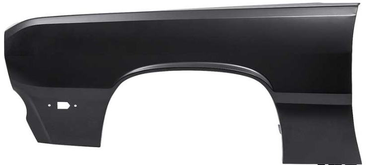

Yes one year only with the surface mounted marker lights, 70-72 Valiant and Duster will fit, but you would have to fill in the 70-71 marker lights and cut holes for the 72 lights...
so the first pic would be 70-71 and second pic would be 72? i guess i could just run the marker lights from the 70-71. also do 73+ work cause ive seen those mentioned as fitting?

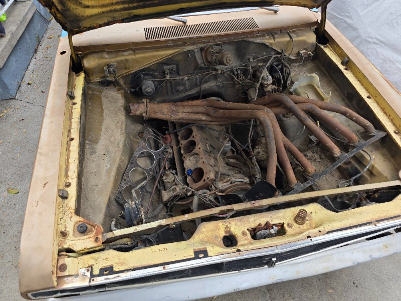

only pic i can find at the moment but this is what it looks like in that corner. also thanks
kinda funny cause theres acutally another 72 close to me for sale that im almost thinking of buying. it doesnt look like things have been changed like my current one.

Looks like your fenders have the brackets.
So even if you do need new fenders for other reasons, you could take the brackets off of that set and weld them onto whatever you find. The '70/71 fenders will have the brackets but different marker lights, the '73+ fenders would have the right marker lights but would need those brackets. I don't think the '67-69 fenders have the brackets either, and they have different marker lights as well.

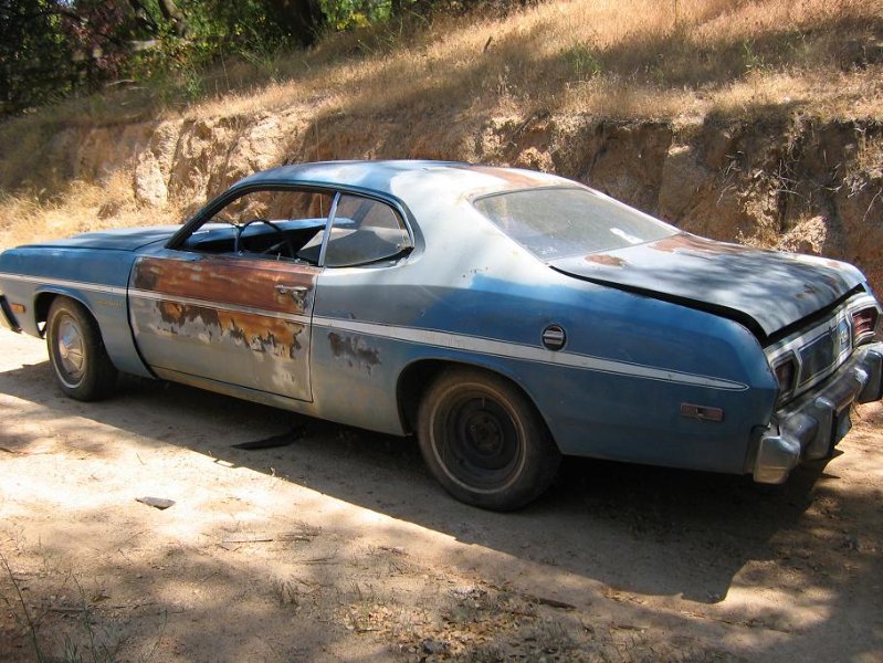

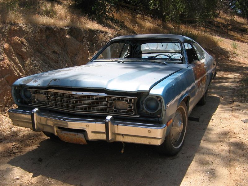

My FrankenDuster was a 1974 model.
I modified it to look mostly like a '71.
Using a cheap flux core welder, I welded tabs to the fenders so I could bolt on the steel panel that supports the grille.
