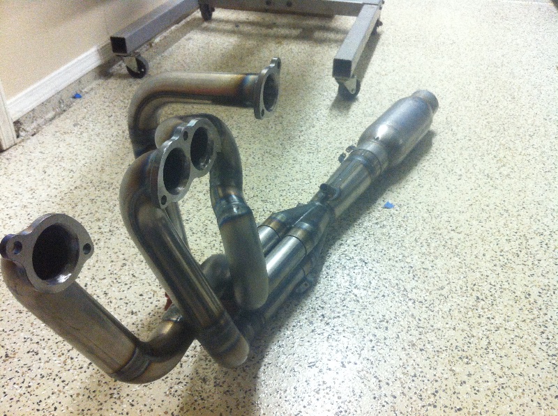

Well I’ll throw this out there….. you could always haul your car to Kingman Az. Greg at REF Unlimited is an absolute artist! Pipes would be made according to your dyno #s and will FIT! I didn’t have much choice with my W8 deal. Made the appt. He rounded up the flanges. Dropped the car off at 7am. Bummed around town. Got the call at 2pm….. “cars done”. I also had him modify my Hedman headers to give more room around the engine for our other mill at a later date.
He made our W8 the same style as our Hedmans with the rear two cylinders going through the fender well.

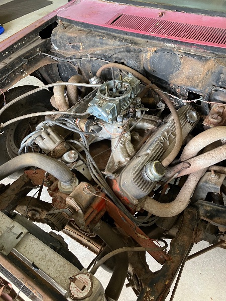

These were headman‘s that I gave away about a year and a half ago. Personally, I think you destroy the structural integrity of the engine bay by the butchering necessary to get these to fit. Just my two cents worth.
These were headman‘s that I gave away about a year and a half ago. Personally, I think you destroy the structural integrity of the engine bay by the butchering necessary to get these to fit. Just my two cents worth.View attachment 1716475776
Correct, in this case you didn't tie anything bars to your upper shock mounts, forward to the frame up by the strut rods and to the body.
Having none of that will eventually bend stuff.
It should have bars like this
If you tear the fender wells completely out you'll certainly need J tubes or similar. A lot of unnecessary rip and tear in that post 15 picture to use FWs.
