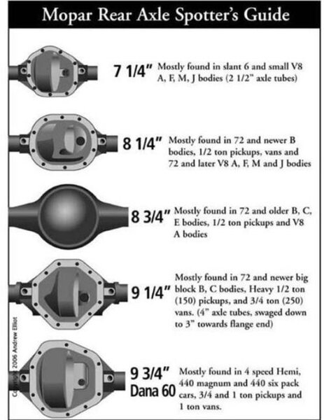

Mopar rear axles. My 70 318 car had a 8 3/4. According to the chart, it could have any one of the first 3.

On a 318 A body, usually someone, the buyer or the dealer, would have to order an 8 3/4.
318's came with 7 1/4" axles up to 72, but you could option an 8 3/4" and it also came with the trailer tow package...
My 67 Barracuda formula S had the factory trailer tow and came with an 8 3/4" 3.23 gear...
I had a 70 swinger that had a factory 8 3/4" 2.76 open gear, but it wasn't listed on the window sticker for some reason...
I'm not sure about the 73 and later came with 7 1/4"....
7.25 with a 2.76 open would be the base and most common rear end. But now and then you could find a sure grip or 8.75 under them
