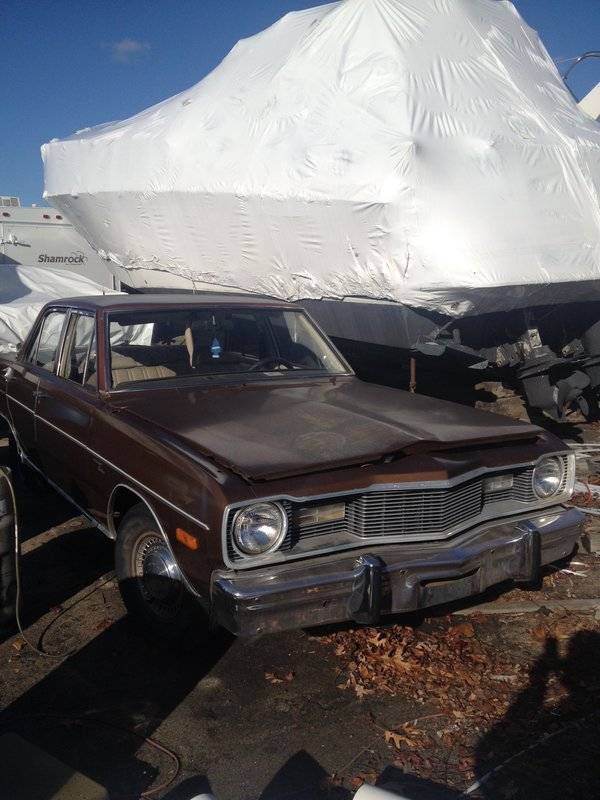

While I was working on the 73 I came across a 71 Duster for sale on Craigslist a few miles away from home so I figured I`d take a look for the heck of it. The car was solid with paper work showing it was a California car most of it`s life. Someone had put a little mud in the bottom of the quarters and painted it with a wagner but the rest of the car was all there. I was so impressed with the lack of rust, (wow was this car in so much better shape than the 73, sorry baby) I had to buy it! It had perfect floors, perfect trunk, doors, fenders, frame, I couldn`t believe how little rust it had ! Just a little /6 auto plain Jane but I still had to have it! I slapped on some rally wheels, registered the car and drove it around while I worked on the 73.

Nice! I picked up one from California too. No rust on mine also. You can't believe they are still out there.
Ya, i`m really looking forward to restoring the 71 too. I couldn`t leave it alone, I pulled the 7 1/4 rear out of it and tossed in a 8 1/4 sure grip and added 4:10 gears. Then I yanked out the old drum brakes up front and put the manual disc brake, big ball joint set up out of the 75 Dart parts car I have (that poor Dart has given up so many parts). Then replaced every front end part and bushing. Ok, thats enough about the 71, back to the 73.
