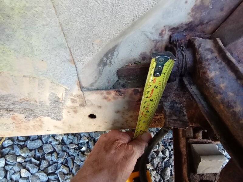

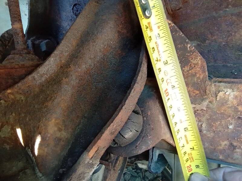

Has anyone used these *MM8186 60-76 A-BODY UPPR ARM MOUNT PR from Classic Industries? I need to know where they mount, measurements from the lower frame to the top of the C Arm bracket. I have it tacked in right now but I don't think my measurements are correct. I'm installing the QA1 coil over system and have to replace parts of the frame due to rust. I think my bracket on the rear arm is too high.

I just finished doing that job on a 67 Barracuda.
I have the rotten stuff I pulled out, I,ll see if I can find it
I have some pix in another recent thread that might help .
Your welcome, anything else, ask, cheers
You got a ways to go, here's what mine turned out like .
