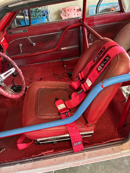

Yeah it still gets driven on the street when the heat and humidity isn’t suffocating around here…like right now. I def added some weight with the cage but I ditched the backseat and I might replace the buckets (those SOBs are like 40lbs each) with some low back alum seats to keep it kinda nostalgic looking. Working on ideas to close out the back seat area from the trunk also.

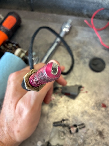

Still putting this thing back together. Wanted to take it for a test drive today but the engine is running like ****. Not sure what happened. Can’t even get it out of the garage. Back firing thru the intake and exhaust. The AFR hunts all over the place when idling. I got a few logs I need to go through and see if I can narrow it down.

That’s always a risk. They disconnected the battery and the ECU before welding but maybe a sensor or something got zapped. I’m seeing rpm sync loss and the fan going off whenever it tries to die. Gonna start with the basics and check all my grounds. Put a new Optima battery in it recently also.

Did it make contact?
Oh yeah. There’s no air in that gap. Took a gouge out of the sensor all the way through the aluminum housing. Not sure when or how it happened but the sensor shifted at some point and got chewed up by the crank trigger.
Yep happens, mine even had a lock washer between the nut and the mount. That sucks. Glad you found it.
It was the crank trigger sensor. Got it replaced and we’re back in business. Got a few details to finish up and hope to make it to the track next Friday, if monsoon season will give me a break.

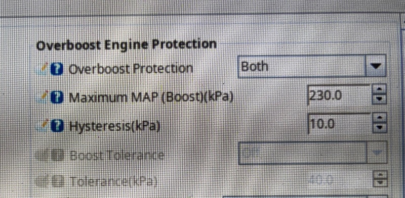

Wish I had thought to check that while still at the track. Came home last night thinking the higher psi was blowing out the spark. The other challenge I have is figuring out the tune with water/meth injection enabled. IATs were hitting 150F but any amount of W/M I sprayed at it spiked AFRs or some other threshold and killed the engine. Gotta dig through the logs and try to narrow that down.
You aren’t alone on that one. I’ve done it, and I’ve seen a bunch of other guys do it. You turn the boost up and forget to add numbers to the overboost. ****, if you watch Cleetus, they do it all the time. It happens.
