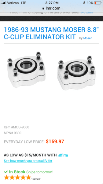

Anybody make C clip eliminator kits for these?
. Yes they do make c-clip eliminators. They are 9” axle flanges with bearings. You will have to cut off and weld these on. But for explorer these are for mustang.
View attachment 1715205118 . Yes they do make c-clip eliminators. They are 9” axle flanges with bearings. You will have to cut off and weld these on. But for explorer these are for mustang.
Mustangs are 28 spline and Explorers are 31 not sure if that makes a difference on the
C-Clip eliminators...haven’t dove that far into them yet!

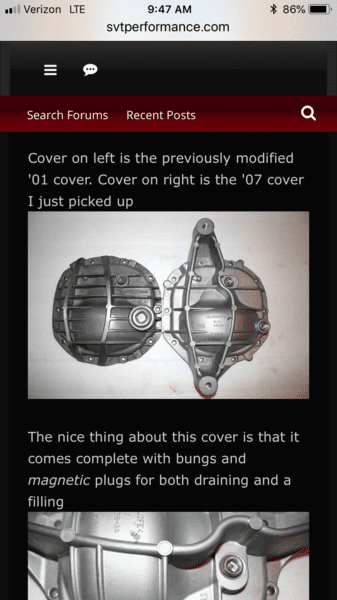

Diff cover showed up. Another piece to the puzzle. Now were is my diff rebuild kit and my new yoke?
You can also get the vented cover with a fill hole and a drain hole off of the Newer IRS Explorers. You will have to trim it a bit but it still bolts up to it. If anyone is at the pic n pull just take it off one and swap it. You won’t be charged for it.

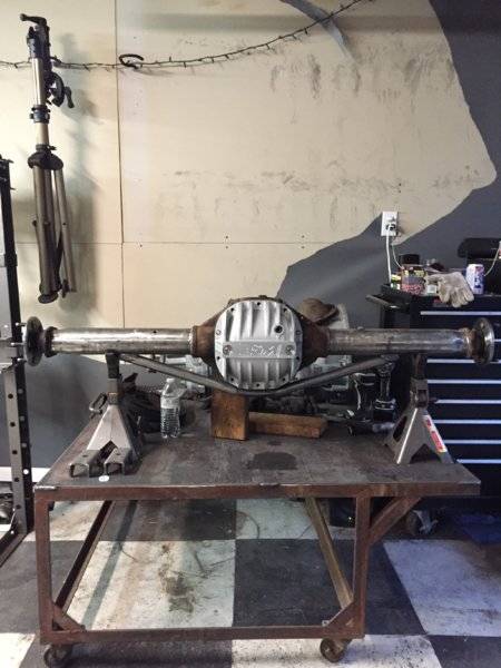

I like your fab table. Thats cool.
Thank you. I was lucky to score it off a local classified ads here in Utah for 20 bucks. The frame is strong and the casters are solid. For some reason they put 18 gauge down as the top. So I cut that off and put a 4 by 4 sheet of 3/16 on it. Total into it 100 bucks. Well worth it.

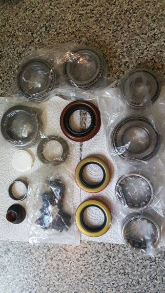

Picked up this kit w koyo bearings off evilbay on a 15% off one day sale $65 shipped. Also during this sale i picked up a yukon gear crush sleeve eliminator $45, and a yukon gear clutch kit with friction modifier, and new cross pin bolt for $56 both with free shipping as well. This is going under my sons car with a mild 318, A904 combo so i'm sure the 31 spline axles and non carbon fiber yukon clutches will be fine.
Kit i saw by strange was made for the 8.8 flanges, no need to weld on some from a 9"axle for that kit. Stated it would work with any 8.8 axle measuring 1.4000" diameter. Disnt say if it would work with rear discs though. Said up to 04 mustang and cobra R . Those had rear discs. I bet they had caliper mounted parking brakes though where the xploder rears use a shoe brake type parking brake.
