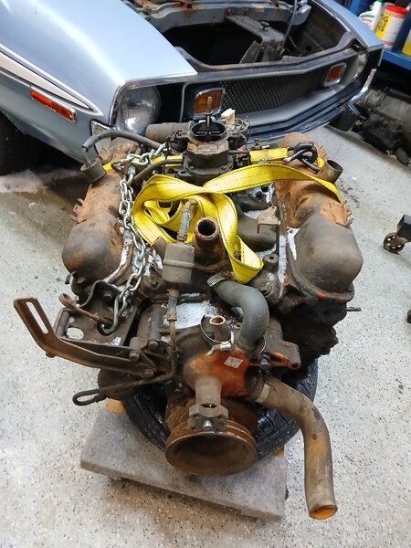

I appreciate everyone's input and thought I'd post a quick update. I was able to score a 273 complete with all accessories and factory power steering out of a '66 barracuda! Basically a one stop shop for most of the hard to find bits for this project. Will probably start a build thread and link it here later when I can get some work done if anyone's interested.
