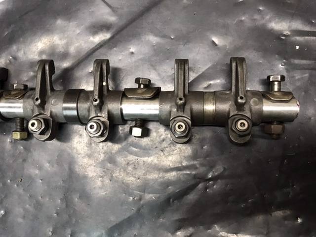

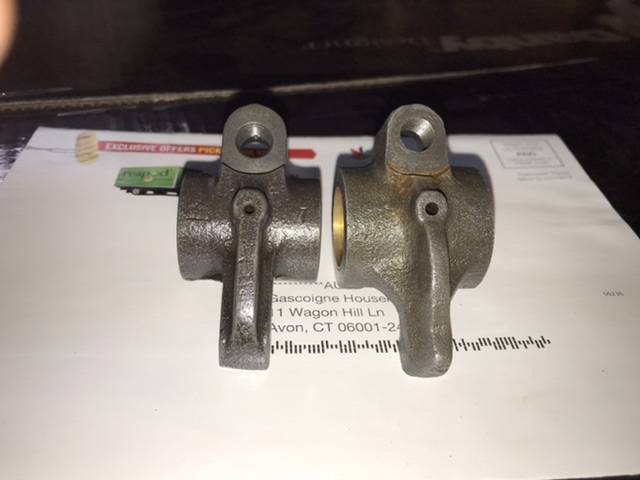

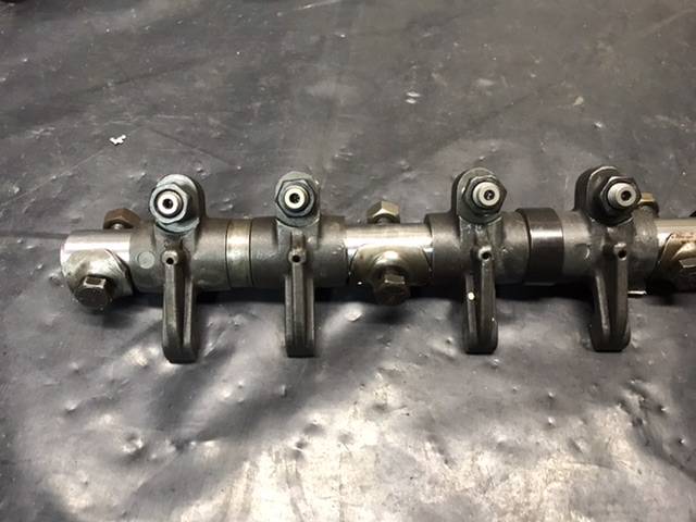

The small block Crane iron rocker kits did come with springs and not spacers. The shafts were not grooved in the Crane small block kit. I have a couple of pictures of Crane small block rockers. I am posting one or two on my phone but may have more at home. Ignore the shafts in The background as they are not Crane shafts.
Crane in third picture is one on the left.
The rockers are offset. They’re for a BB.
SB rockers are straight(all 16 the same, no lefts/rights).
The SB Crane rockers don’t really look anything like that.
They’re more like 273 rockers, but “beefier”.
Edit, I see Rocket has a pic of one above.
View attachment 1715607147 View attachment 1715607148 View attachment 1715607137 View attachment 1715607138
Yes , thank you Rocket . Yeah I'm familiar with the crane small block rocker arms which is what I was told these were. Tell me the middle picture as the post appears to me in your msg. the rocker arm on the right hand side bushed . I can see the bushing in it with the arched rib above the arm , what make is that?
