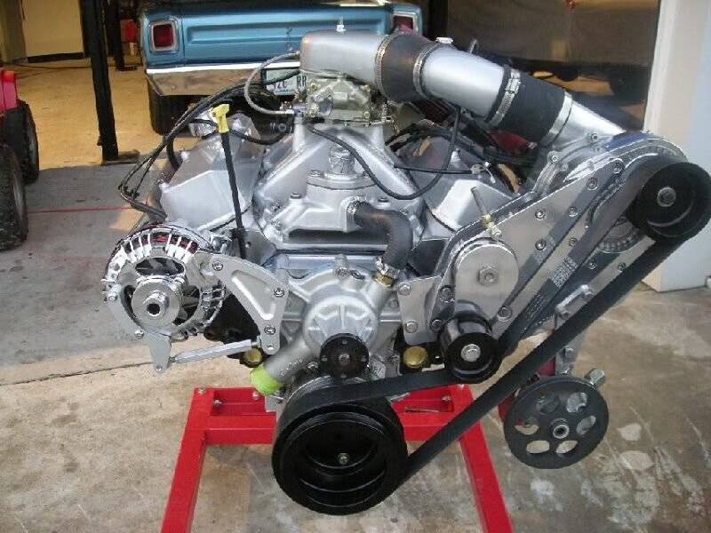

I have a roadrace Milodon pan on my 416 engine, below, I can rob or just buy a new one.It really needs a rear sump anyway.
I have a 650 hp 408, below, in a 5-speed 70 ‘cuda and the 550hp 416 waiting for another project.
