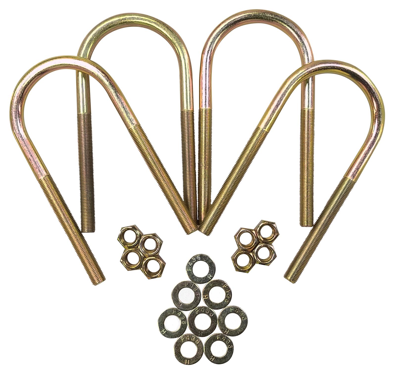

I had a 8 3/4 where you could see the outline of the round U bolt in the outside and the impression of where the U bolt crushed the stamped steel tube on the inside.
Its all point load, the flat distributes the load over a larger surface area where as the round ones distribute it over a VERY small surface area.
Remember the 8 3/4 is a stamped / formed sheet steel housing, it is not thick steel tubing like Dana 60 and 7 1/4

Yeah. It's however long they need to be, just like @junkyardhero told you in post #36. So here's why that is. Whatever springs your car has may be a thicker or thinner spring pack than another car, resulting in the need for a different length u bolt. Get it? There's no blanket answer, as different suspension packages likely had the need for different length u bolts. Lose sleep over something worth losin it over.
i recently bought a set from AMK, They offer 2 sizes if i remember correctly and they have the flat spots for the tube.
