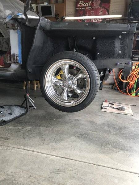

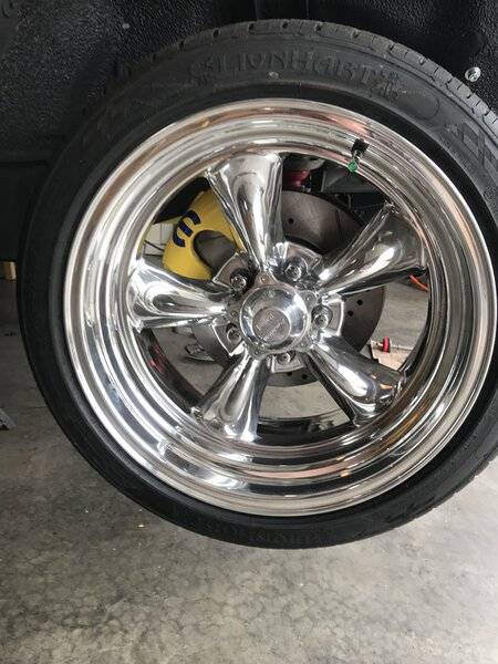

I aquired a 1969 barracuda with BBP. setup with discs from a 1973 Dodge dart (I beleive ). It came with 15 inch rims and now has P215 R15 95H tires which touch the fenders in a turn . I beleive this is what caused the previous owner to crash the car and led to my aquisition of the car . The car would originally had 14 inch bias ply 70's . I either put narrower or lower profile tires, create an abnormal lift, customize or roll the fender back (unless something else is incorrect??). If there is a post that resolves this problem could someone direct me to it . I don't want to start a thread if the info is out there already and I beleive someone must have tried this before. Any advice much appreciated . Thanks
Richard are you sure you’re not missing something about the tire measurement that’s on it? If it truly is a 215/95/15 that shows a 31” diameter tire which is wayyyy to big for our cars I think. No wonder it’s rubbing the fender. Double check that tire size as most of us don’t run anything that big.

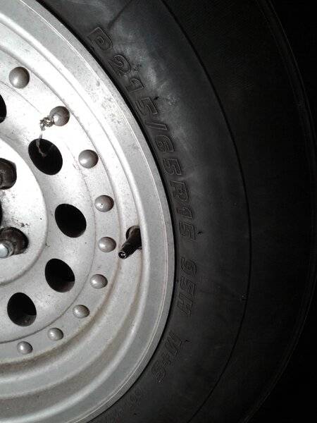

Can you post a picture of the tire? 95h sounds like a speed rating. I'm sure it's not a 95 series tire.
Just measured the wheel diameter. It's about 26.5 inchs however its almost 9 inches wide . I think the width is the critical problem . I have different tires I will mount shortly and advise. Thanks.
215/65r15.
I didnt read all these posts , are those ur front wheels ? how wide are they ?
Those are my front wheels. I started a thread on the NEW steering and suspension Forum . These rims appear to be 7 inches wide( I haven't got a good caliper so I am guestimating ). I beleive the diameter should read 25.5 inches. According to other responses on the steering and suspension forum this is not a simple conversion.
I now have 8.5`s on the back of my car, would like to have some fronts to match , but 7'' is the narrowest ones they made , maybe 6'' , but I dont want that much weight up there .

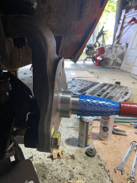

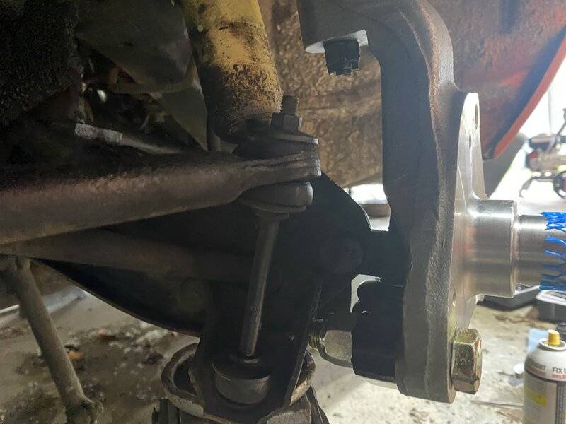

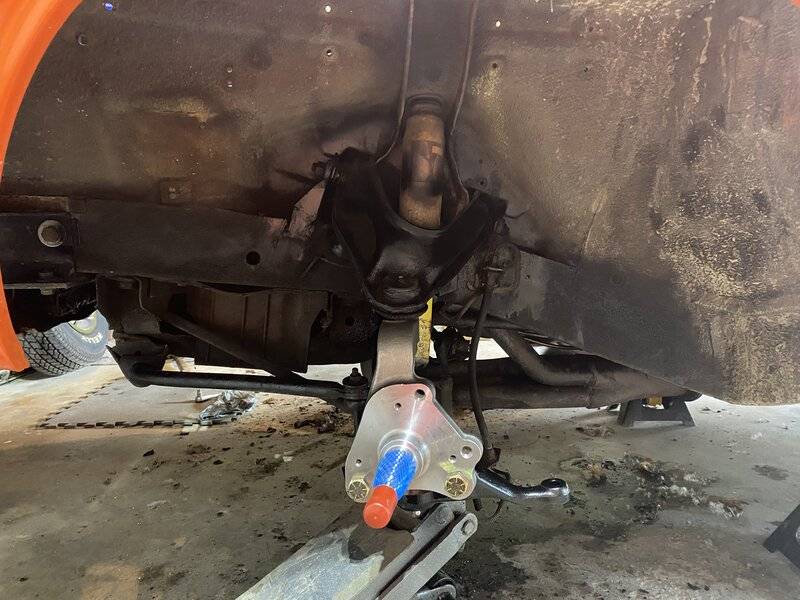

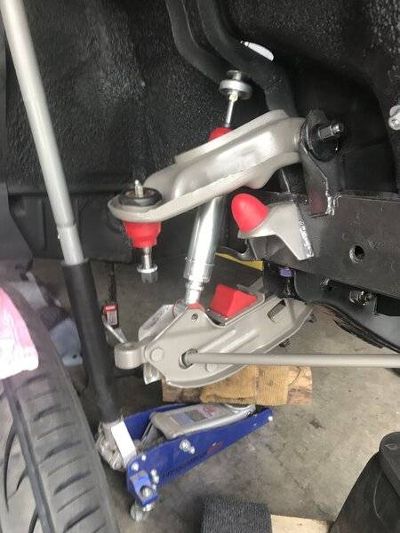

Anyone have this issue? The spindle bolt is hitting the control arm where the sway bar bracket is welded. Won’t turn near far enough.
