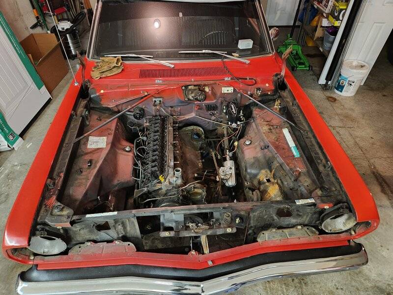

Some good disassembly progress today getting ready for all the new goodies... Also decided I might as well go ahead and get the Dutras while I'm at it, so I'll order those this week.
Starting point this morning
Ending point with the new manual steering stuff partway installed...
Bunches o' stuff stripped off...
Decided since I'm in it this far I should also clean and paint the engine bay... bunch of ziebart in there too that I need to clean out... Went ahead and stripped out more stuff, wiring harness, grill, lights, etc... Fingers crossed I think I just need to remove the 4 bolts to the TC through the starter hole and then lift the engine out... pretty sure everything else is disconnected already, but it is my first time yanking an engine- Hoping for another positive update for y'all tomorrow.
Went until I ran out of paint... ordered 2 more spray cans of the FE5 red and some more of the plain black for bottom of hood.... wanted to do red on the bottom of the hood like it used to be but the black is like 1/10 the cost of the red, so making that sacrifice... at least it'll be fresh and clean... the red has a clear coat it still needs but I'll wait until the other cans come in and I can cover the thin spots before spraying the clear on.
