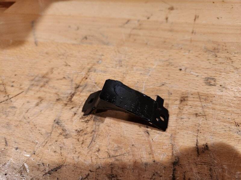

I'm in process on locking the distributor so there is no mechanical or vacuum advance, which appears to be what is necessary to work properly with the Sniper since it includes an option for timing control once I bought this special "Coil Control Module"... Hopefully finish that lockout tomorrow. Thinking I'll try to get the motor bolted back into the car this weekend. Then after that there's gonna be a bunch of wiring, fuel lines, tranny cooler lines, exhaust section from the Dutras down to where i hacked off the TTI Headpipe, etc to do... Getting closer and still have a lot to do, but pretty confident it'll be ready to go by the time Spring rolls around...
Gotta pick up a few #10 flat washers tomorrow, but aside from that I think I'm done with the lockout of the standard electronic distributor... Even managed to use the old tag that was on the distributor along with some more JB Weld to cover the hole left after removing the vacuum advance canister...
