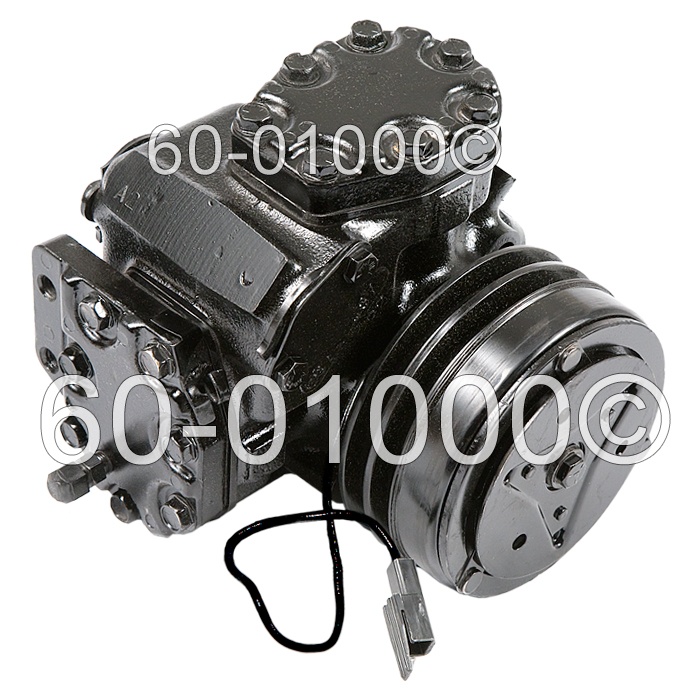

1968 Newport type:
1985 Ram type:

Here goes. In my opinion, I would not use either. The 1st compressor in your pictures, is called an RV-2. It was a good compressor in it's day, but heavy and has a "odd firing order", like a Harley bike, which causes vibration.
The second compressor is the C171, or A 590, I forget which (having a senior moment). These are getting hard to find, in good condition. There are Chinese copies, but they are poor quality.
Since you are going to need custom brackets, anyway, I would use the Sanden style SD-709 / SD7H15, or Sanden style SD-508 / SD5H14.
These are available new real Sanden, or new Chinese copy cat. The Chinese versions are actually good quality, and less money. As for hoses, any good A/C shop, can make whatever you need. Make a winter trip to Florida, and I can make the hoses for you :) .
I would also upgrade the condenser to the new parrallel flow style, will make a big difference
The V twin is a Chrysler V2 compressor. I think the other is a Sanden. It's either that or a Nippondenso. The two look very similar. Most people consider the Sanden/Nippondenso an upgrade, but I don't. They both have their pros and cons. The RV2 is a lot heavier, but it's extremely durable. The other is more compact and lighter. They will both do a fine job at cooling. If you have the room, run the RV2. If not, run the little one.

Most classic car modders use a Sanden. You can get brackets to fit a 383 at Bouchillon Performance and others. Several sizes of Sandens, w/ differing lengths, so see which fits the brackets. I have seen H13 ("shorty"), H14, & H15 in increasing size. The H13 should be OK for PA. SD7 (7 pistons) is better & newer than SD5. You can get various backs w/ ports. Most modder's use one w/ #6 & #8 side O-ring fittings. The H numbers are R-134 and 508 & 708 numbers R-12. You can use either if you drain the oil and use proper. I would use PAO 68 oil with any refrigerant today. R-134A is soon to be outlawed.
