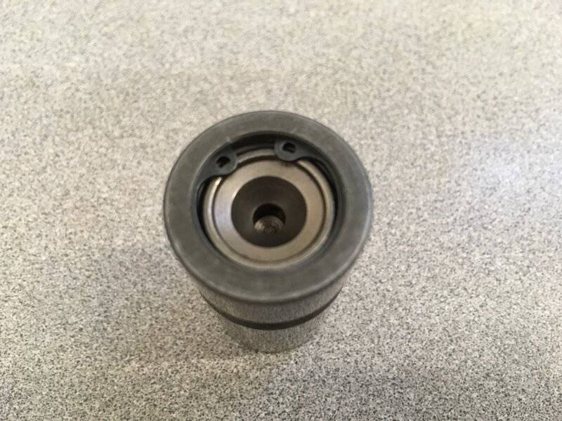

Here’s a pic of some 1993 vintage Lunati Micro-trol lifters....... with what I consider the “good” style retainers(snap ring):
