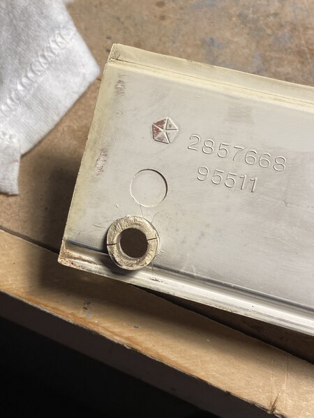

  • The previous owner was a heavy smoker and the stains are hard to remove from the unpainted surfaces. I’ve tried alcohol; water based cleaner; and paint thinner - they all work but it’s a very slow process. Any recommendations for a fast working cleaner? I haven’t tried a solvent based wax, grease, and silicone remover

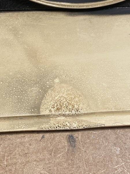

  • What is the best method to repair the heat damage?

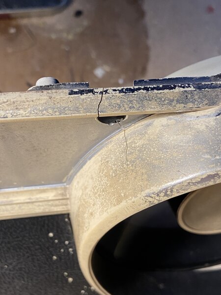

  • What is the best glue to repair the stress cracks?

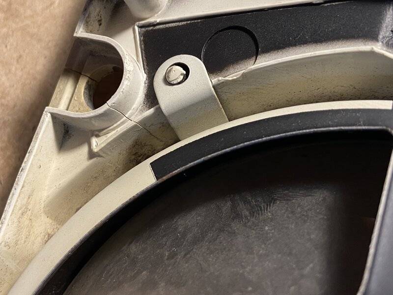

When I was redoing my 69 cuda plastic grills I used a JB weld epoxy. Worked great, sandable.
Side note, in your last pic, chk the metal tab that holds lens in. Looks like plastic is missing that holds it firm.
Tnxs. I was going to use JB Weld to refasten it once I fix all the other problems
I believe the plastic is polystyrene. I would try testors plastic model cement on the cracks. Be careful where you get it cause it actually melts the plastic. Any kind of plastic body filler for the marred surfaces, but sand the area with 60-80 grit sandpaper so the filler has something to stick to and grip. Again testers filler. You can shape the filler by white glueing sand paper to a paint stir stick. Sticks can be cut to any size or shape to suit/reach specific areas. Don’t forget to prime with a high fill primer before you paint.

I like JB Weld. I found recently Devcon Epoxy works awesome as well. It's one of my favorites now. The dark gray works great. They have one that dries cream color as well.
Devcon Plastic Steel Epoxy, 25ml
I've heard/read good things about Devcon. We have limited selection up here, and if its avail its pricey.
JB was like $15 and worked perfect.

JB weld sells different types of 2 part epoxy for plastic. I use the tan/yellow for build up and clear for repairs. Auto Zone has them all.
