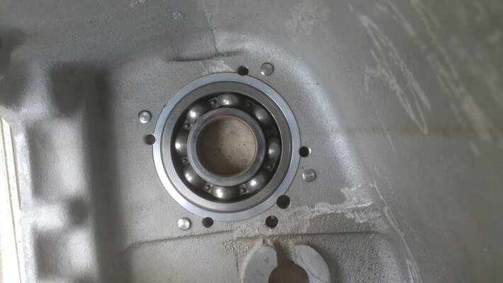

Been missing for a while due to getting hit by a semi rolling about 90 on i10 interstate in Arizona 3 years ago. Concussion, neck injury, and reconstructive surgery to arm and shoulder. Lots of painful physical therapy but happy to get to 85%. While taking my 833 apart I discovered that someone dropped the the trans and on the bottom is a spider crack silver dollar size. Found a aluminum OD case and tail housing that was converted to 307 main bearing. Looks to be excellent machine work and I didn't pay much for it. Hopefully all my regular 833 internals will drop in. Anybody here seen a conversion like this? Strength wise, do you think this will handle the 360 # 5302006 block "roller"
A833 alum inside.jpg I'm building into a 408???
View attachment 1716081636 I'm building into a 408???
I'm curious to know this as well. I've read some threads here where some folks say you'll definitely blow it up, while others say you'll be fine as long as you bush the countershaft bore and keep it on the street.
Hopefully we can get some knowledgeable people to chime in here.
Bush the counterbores. That is the weak link. Slop in a transmission is bad. The cheapest and best way to tighten and strengthen an O/D is to swap the main case for a standard main case and use a standard countershaft with either front bearing. A reconditioned 307 main case only runs about $125.
What kind of HP are you talking for there to be weak points? Didn’t really follow your previous reply. Bushings in the counterbores, 307 main case? Like a cast iron one? Forgive my lack of knowledge but definitely want to make sure I do research before buying something. The motor is stock as of now with a mild cam. Plan on building the 340 to 400 hp in the future.
What O/D are you looking at? There are a few variations. I know of one person who installed the O/D gear set and mainshaft in an original cast iron case behind a 440 and is happy with it. I have run them in my cars, but I typically only run a 273.
I’m not sure which ones yet, he has 5 of them. Waiting on pictures and numbers from the transmissions. Just want to make sure I’m not getting something that I would be better off waiting for the right set up
I would suggest a 30 spline output shaft. Make sure it is an A-Body trans. I swap to the early, without a Vin Pad, standard cast iron 307 front bearing main case in any O/D I'm going to run in one of my cars. Pictures for reference. Passon Performance has them as well. Pull the side cover and look for damage. Get Passon's book on rebuilding 4 speeds, Chrysler A-833 Transmissions — How to Rebuild and Modify . That will familiarize you with the different combinations.
