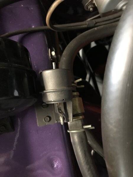

Can anyone tell me where I can get this valve? I’m assuming that this is the correct original for my 71 Duster 340 ac car?
