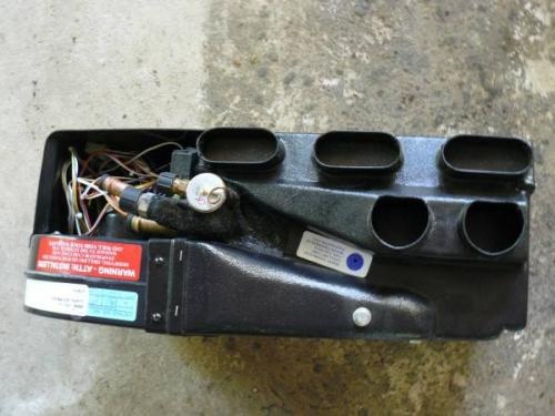

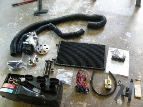

Then, in the midst of that, I ran into a local guy with an "almost complete" Vintage Air kit
attachment.php
attachment.php
In the photo below, the firewall side of the unit is at the bottom of the photo. The two round holes connect to your defroster outlets. The three oval fittings are A/C outlets, and "you can't see" the heat floor outlet out the bottom of the unit

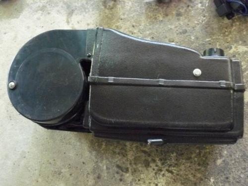

The only downside ? is that there is no provision for fresh air, and you'd have to "do something" with your original fresh air cowl fitting. Some guys claim you can adapt a driver side fresh air box. Look at the thread I posted. I may adapt a Mustang air box as I did for the drivers side.
attachment.php
This very quickly changed "my direction."
This is similar to what was posted above. This is a complete, self contained heat / defrost / under dash unit, that requires NO firewall entrances. In other words you can re-route the heater and AC lines out to the wheel well to hide them better. I will probably use the factory heater hose openings in my (non AC) firewall.
This unit is VERY compact, and you can look up the specs at Vintage Air
This box is called a 68000-VUZ-A is known as a "ComPac Gen H W/DEF" and if you Google that you'll find "stuff" on it
Size of unit from Summit:
As you can see it's VERY small
