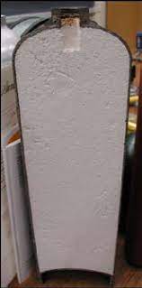

I always found it fascinating that an acetylene bottle holds more acetylene once you have the porous mass and acetone in there.
Just watched a video of a guy taking a bottle apart. The material inside is diatomaceous earth. Interesting stuff.
