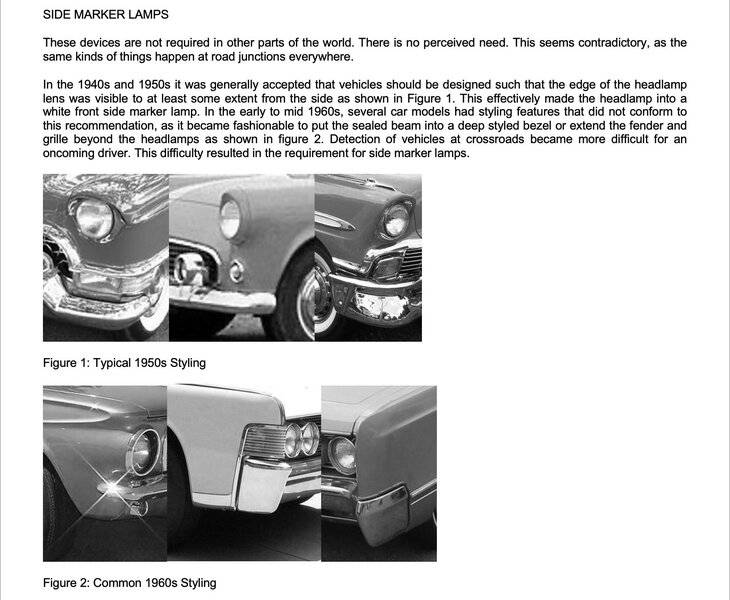

Why sudden interest in side-on visibility of cars? Here's an image from a 2010 tech talk on the subject by one of America's rockstar vehicle lighting optical engineers, who started his career back in the sealed-beam days and ended it recently in LED times. Note one of the vehicles he used to make his point:
