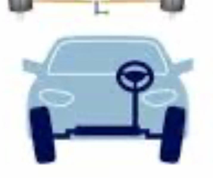

73 Duster with stock suspension.
I need to correct my front tires as they are currently in positive camber.
Two questions:
1. Do I turn the adjusting nut on the upper control arm clockwise or counter clockwise to correct this?
2. Do I turn the front facing or rear facing adjusting nut on the upper control arm?
Cheers
