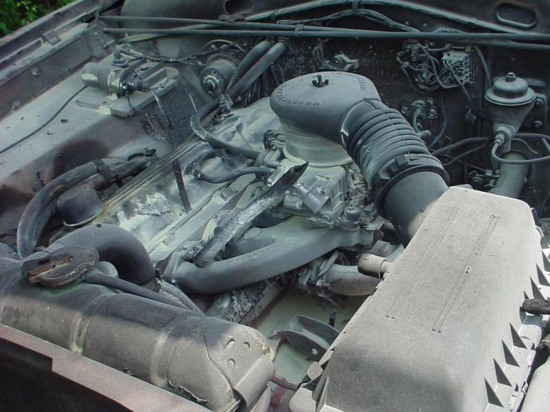

Could this new Voltage regulator quit on me :-k It is a re-pop for electronic ignition, My other one got toasted whem mother nature hit her with lightning last year and I have been running my old points style regulator till about 3 days ago.

here she is after mother nature touched her last year:shaking2:

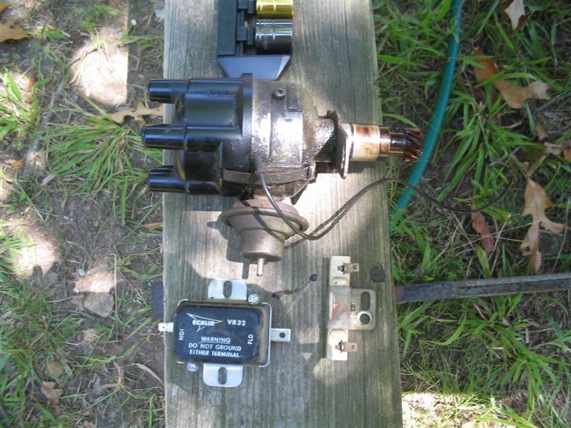

here is an old one for you when I did the point's dizzy change out about 3 1/2 years ago :D

check the voltages all out after you get her back runnin with the new ecu.
i think if the repop regulator you are using is not stable, it could be what damaged the ecu.
I was woundering the same this, That is why I have the old one that came with my points system back on, it was the first thing I changed out moparlover, what should be my voltage going to my ecu ?
Or sould I test the voltage leaving the regulator at different RPM ranges ?
I am thinking I should change to the new style with the triangular two pin regulator and high jack a plug from my old truck wire harness :-k
Mike you don't necessarily need to go to the new style regulator, and of course you need the 70/ later isolated field alternator (often incorrectly called "dual field.) You can also use a Standard Motor Products VR-128 in place of your '60's regulator.
One problem with OVER charging is voltage drop in the ignition harness. Easy to check----
Turn key on, engine off. Put a meter on the battery positive post, the other probe on your IGN terminal on the regulator. You are hoping for a VERY low reading, lower than .2--.3V (2 TENTHS of a volt.) IF higher, you are "losing voltage." Your top suspects are the bulkhead connector, connector on the IGN switch, or the switch itself.
Next, check the ground integrity. To do that, start the engine on fast idle, put one probe on battery NEG and the other on the regulator mount frame. Be sure to stab through any rust, chrome, etc.
Again, you are hoping for a very low reading. Over .2V means the block/ body/ battery/ regulator are not truely grounded.
Last, with the battery "normalized" and the engine and regulator warm.,, check battery voltage right at the battery on a fast idle. Optimum is 13.8--14.2, allowable is 13.5--14.5. Anything over/ under means some amount of trouble.
I read this twice and I will check this out and get back to you John :eek:ops: it's that's the wrong name :sign3: some times Thank you for your time posting this :cheers:
