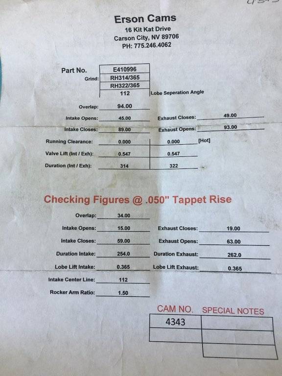

A/J - Not sure on cranking compression, would guess above 160, but a guess. Attached is the cam card, this is a hydraulic roller advanced 6*
Yes, understand the timing, and agree AF will be secondary to the timing. Like Trail said, a dyno may be the best way for maximum but really I will probably do stop light to stop light in a rural area. As for timing, using the MSD box you can program the curve in, the Fitech does not provide that "idle" and then after 2000 all in. So with it locked out I am only going to get 38* (or what ever I program it to.) Yes, MAP is there but will need to play with it to better adjust as needed.

Not laughing at you, laughing at me spouting nonsense for a honking big cam as that.; 314/322/112 with 94* of overlap.
Sorry man,I have never tuned anything that big. Biggest to date was a 292/292/108 with 76 overlap.Plus I just noticed this is in the BB section, and my experience with those is very limited. I guess I'll go crawl back under my rock.
