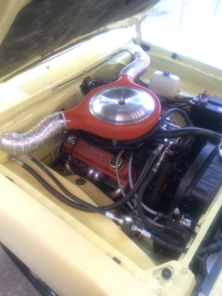

My 340 with the Edlebrock Air Gap Intake with a 750 eddy Carb and yes unfortunately my hood had to be cut and dual snorkles added.
OK, thought something like that? Any idea how much drop I need?
