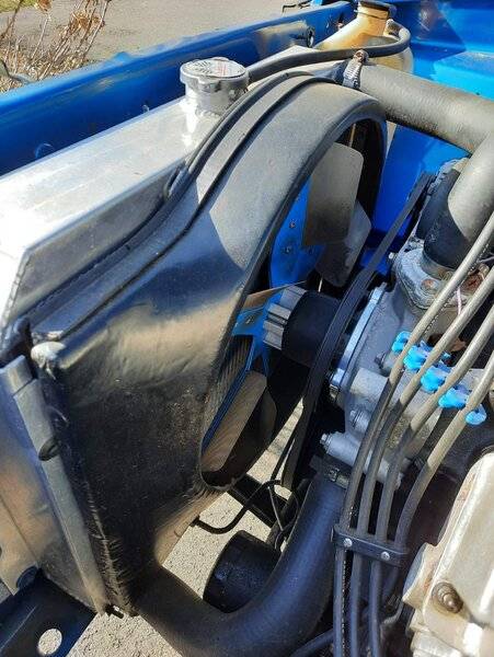

I made one for my Hardtop. It was fun actually. Of all things I used a Dart board .lol
I took plywood and dartboard, covered with 6mm plastic, got some stretchy fabric from a fabric store, brushed 2 or 3 coats of fiberglass resin. Popped it off the mold, reinforced the inside with fiberglass mat until thick enough. Added my side brackets and painted. I’m sure I would do a few things different but still worked out great.

Nice work Kendog..!! I made up a snowmobile belly pan the same way. A lot of work but worth the effort..!! Swingn’
