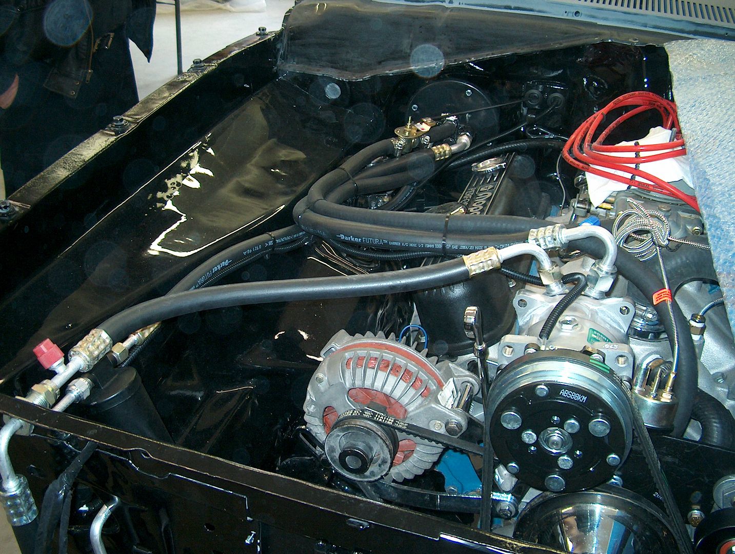

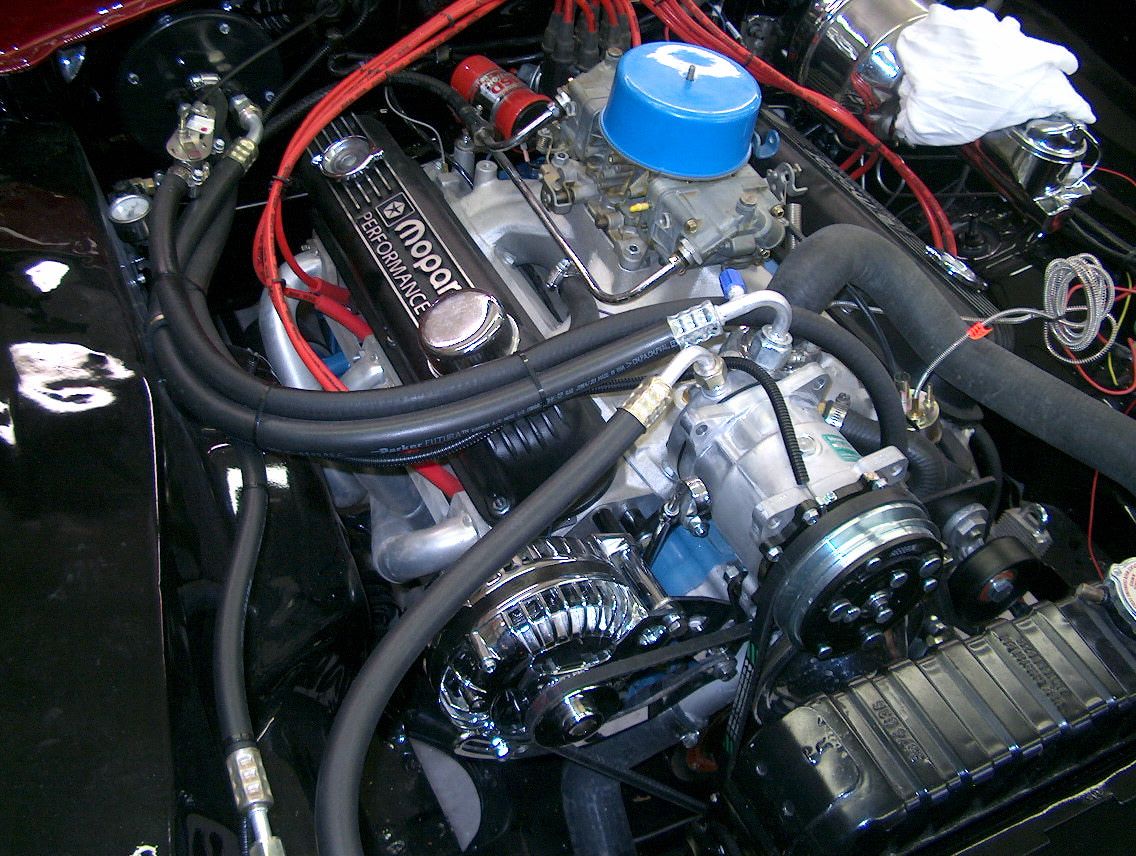

I don't know that these shots will help much, but this is in my '72 Demon with a 408 & Eddy heads showing with the old and new alternator.
