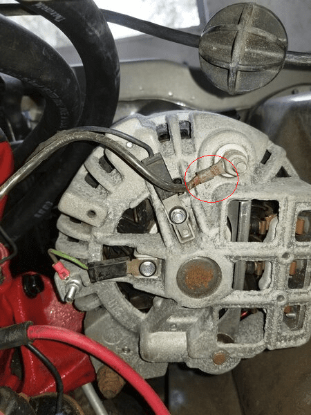

Got the wiring up graded, new charge terminal, wire was clean when cut & stripped. Ran a blue ign wire to the previously grounded field terminal. Waiting on the regulator & pigtail to arrive this afternoon.
Yes I did look, imagine my surprise to see this!

I got a better pic of the old regulator, I was surprised to see it is electronic! There is some discoloration along the large solder run.
