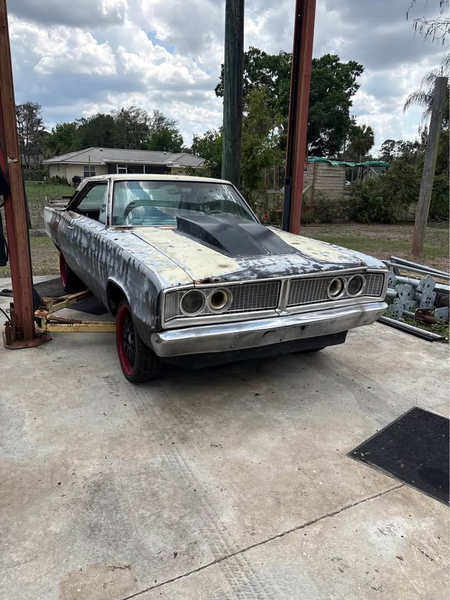

Al when are you guys picking up this lovely scrap metal? :lol: 1966 Dodge coronet · 440

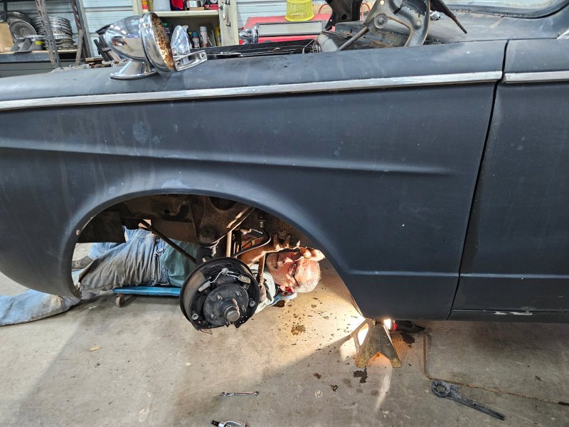

Then I opened the can of worms on the front ball joints. Gonna turn into a full front end rebuild. But I have most everything I need on the shelf !

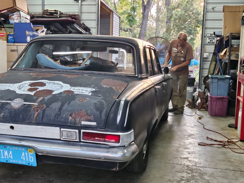

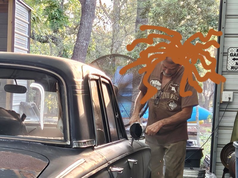

Was grinding off the Pizza Logos of the hood and deck lid. I ask Theresa why she always gets my bald *** head in the picture.
So she fixed it ! LOL.

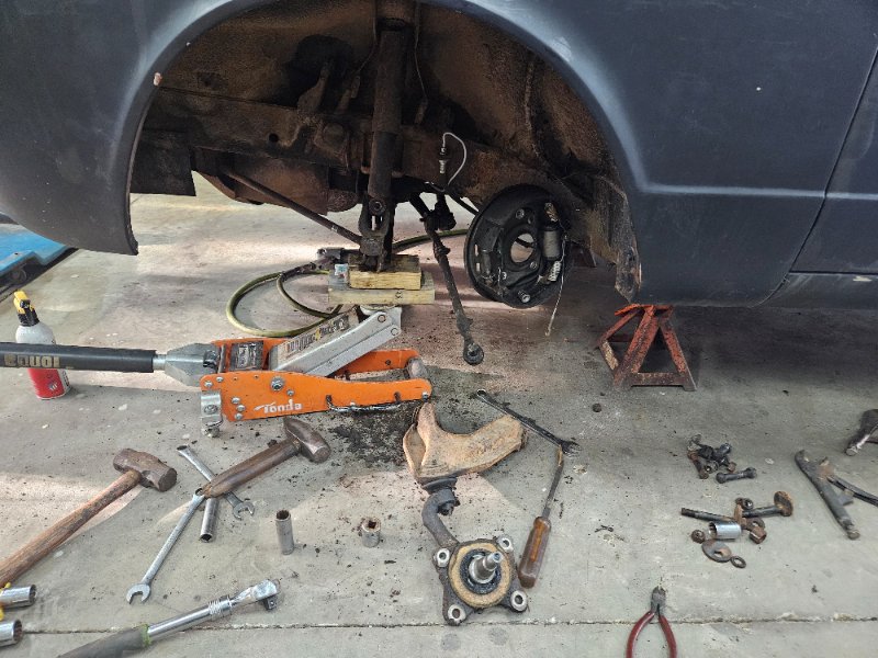

Pulled all the front suspension apart yesterday & today. Bought some lower ball joints. Mevotec.
Just about to wrap it up till I found they have 9/16 bolt holes instead ot 1/2".
Drilled out my knuckles but couldn't find any bolts local. . Amazon to the rescue ! Be a couple days then back at it.
I had newly rebuilt upper and lower control arms. Some 340 T bars to go in.
Kinda nice having parts on hand , just grab & go back to work.
Came to a screeching halt with the 9/16" bolts though. 9

Where is that 66 Coronet?

I need 9/16 bolts. Hopefully ACE has some. You can click the link on the Coronet above. I thought it said Fl.
