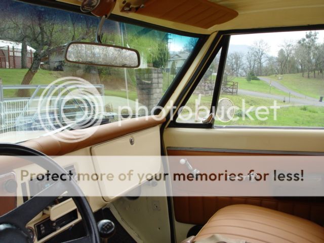

I know this isn't going to work on some vehicles but the object is to save the original foam itself and recover it with new upholstery and this is what I've done to my 69 GMC, photo isn't that perfect yet the work is.
