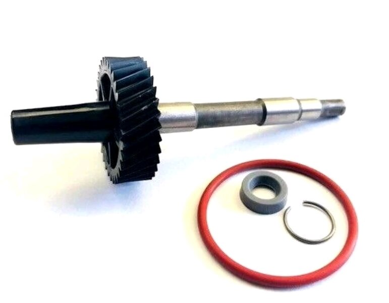

I swapped out the original speedometer gear in my transmission for a 32 tooth gear. I had a bouncing needle at all speeds. I originally just replaced the gear and ran the original cable. My needle then went dead so I have ordered a new cable and will be installing it Saturday. I noticed when I removed the original gear there was no small o-ring. Install the new gear with a new small o-ring. Could this have caused my needle to stop working altogether? I also noticed that some sellers of the long nose gear include a snap ring. Does a 904 require a snap ring somewhere? Lastly if this new cable doesn't work, what's the best way to clean the sheath on the old cable? I went through a can of brake fluid cleaner and never got a steady stream to come out of the housing sheath.

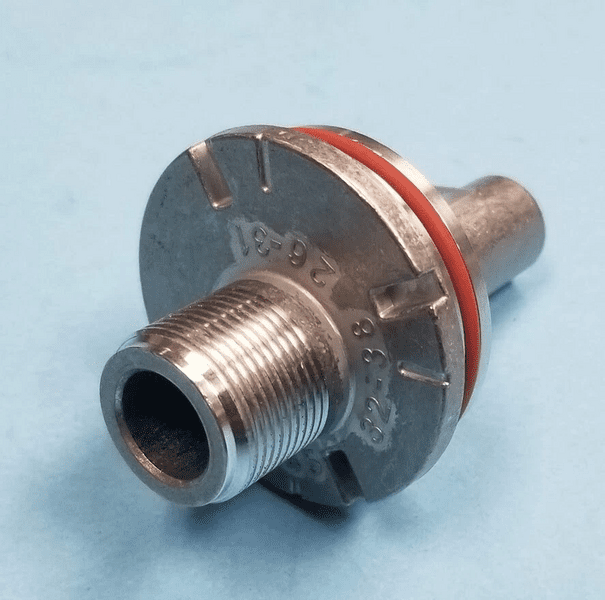

I thought I had it clocked properly. I have a housing that has the 4 hash marks but it only has 1 set of numbers. I clocked based off of a picture I found here of a housing with numbers by each hash mark. I may just have to get a new housing to be sure it's right.

There are two different housings- one for 21-25 tooth gears, and one for 26-45 tooth gears.
If yours has only one set of numbers and is marked 21/25, you have the wrong adapter.
The correct adapter should have all hashmarks marked with a range- select the one marked with your tooth count.

@profeyou were right. I have to swap the housing first. I don't have the right one. I ordered a proper one from Mancini racing. From there I will follow the procedure to check if the speedometer gauge housing is bad.
The speedo gear housing has to be properly clocked for the gear you are using.

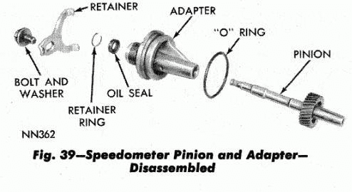

I believe the gray O-ring and snap ring stay in the tranny. Without it it will leak
Sort of. They are inside the adapter the gear attached to. The factory service manual, available free download from mymopar.com has a cut away and install instructions.
