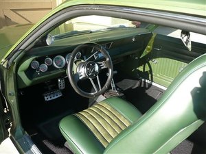

I had mine recovered for an X-mas present from my dad. So I don't know the price, but here are the results. And sorry that I don't have a good picture of strictly the new seats after the recovering. Both pictures I had of them would not upload. The buckets were out of a Roadrunner Volare, I believe a 76. Correct me if I'm wrong, it would be good to know :)
Ya Ya I know, the passenger seat wasn't installed at the time, haha.
