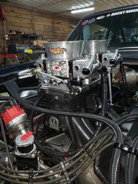

I run a pair of these short stacks form PJ Motorsports on my junk. Velocity Stacks For Hot Rods
Yes, you can make them yourself cheaper - but for me, there are tasks where I have more $$$ than time for!
Hey I recognize your engine. Lol I have a picture of it saved from Facebook. I got the ideal and made my post because of them. How do you like them? Have you ever raced with them on and off your engine?
