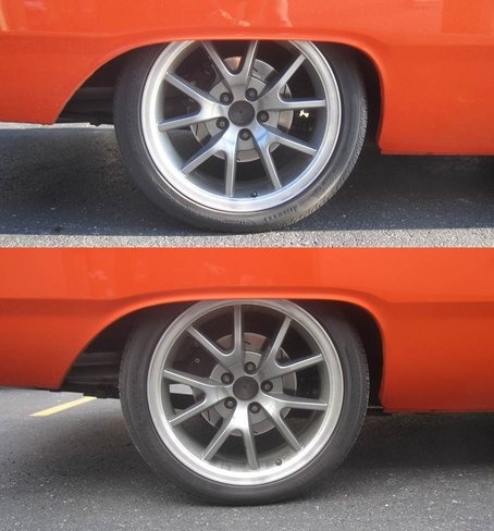

I'm considering them for my 70. if anyone could post a pic I would be interested how low the car sits on the rim. Thanks.

Thanks Carson. What size rims are those? I'm on 15s now and trying to get an idea where the fender lip will end up.

This is the turbo Scamp that was done for Fram Corp. This is a side by side photo of the stance with the H spring and mine. The wheel is an 18".
