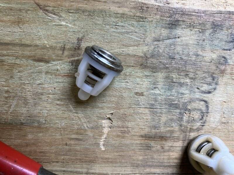

Think I just found something…..
Never had an issue with this pressure washer when we lived in the ‘burbs, but now we’re “out in the sticks” a way and have our own well. We installed a whole house filter when we moved-in, but every now and then something in the system gets loose and jambs up the toilet valve, a faucet, etc.
Submitted for your approval, Exhibit A: No water inlet screen.
And Exhibit B: Two check valves stuck open with sand in them.
Pretty hard to see there (I’m no photographer), but zoom in on this one to see the single grain of sand for an example of what was holding one of these open:
Blowing through them can make them stick in the open position at times, and the o-rings are damaged, so for now, just for shiggles, I’m going to throw it together and see what happens. And IF it works, and IF I can find new parts for it, I just may be able to save it
And I’ll open up the regulator/unloader as well when that time comes.
More to follow…..
Edit. On second thought, I have too many other things to do, so I’m NOT going to take the time and reassemble it until I have the new parts in-hand.
Edit ditto. But on the third hand, why order parts for a something that’s dead? Let me see if I can scrounge up a screened inlet washer here….
Update: No joy on putting the old check valves back in, and the regulator was full of **** and came part in my hands.
Guess I’m buying a new pump.
