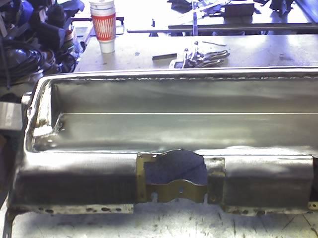

Had a rocky mountain style dash - didnt like it, looked a bit too basic for my taste. Made this by hand using 3 ml aluminum sheet and 4.5 inch tubing, in basic shape of factory instrument bezel only for a right hand drive car (as mine is). Mounted classic instruments white hot gauges (white, to match my 4 speed white ball console shifter) behind the large openings (so you cant see the guage bezel) for more of a factory look (dont like the look of aftermarket gauges just stuck onto a piece of flat sheet) and used angled bezel under the accessory gauges to make them sit at the correct angle. Added "Splitfire" gauge bezels to the accessory gauges to match the look of the large gauge openings in the dash. Finished it all in back wrinkle finish. Easy enough to do with basic skills (like mine), and welding the 3 ml aluminum didnt prove too hard.
WOW!!...that really looks the parts...the gauges almost look like they're floating!...very well done sydcuda:toothy10:

I really like the dash so far...is that steel construction?

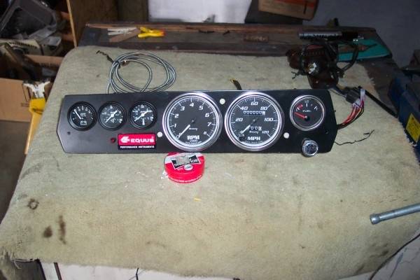

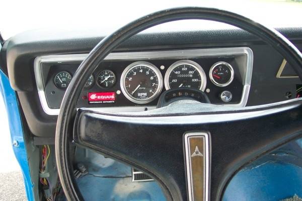

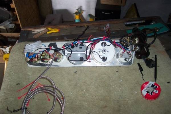

Depending on how much time and money you want to spend, you might consider what I did. I took the less painful route, and pretty much used instruments I had on hand. Purchased speedo and tach, however. Used a sheet of about 1/8" thick aluminum

That's a really nice wiring job...I noticed that you used connectors to remove the dash if needed...very nice work!...I do the same thing when I make custom dashes...use LEDs for turn and high beam indicators and brake warning light.
I too am wanting to upgrade my dash and guages.... but I love the look of the rectangle speedo. Has anybody added guages but retained the factory speedo????

yes its 16ga steel. The cluster will be from Nordstok and assembled from individual gauges.

I used all autometer gauges, 5" tach and speedo and 2 5/8" gas gauge, all fit in the stock location with alittle trimming. I then used 1/8" LED light for the turn signals and high beam. nice dash for no money other than gauges and $10 for the LED's
