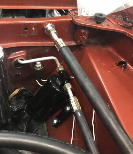

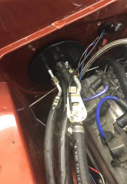

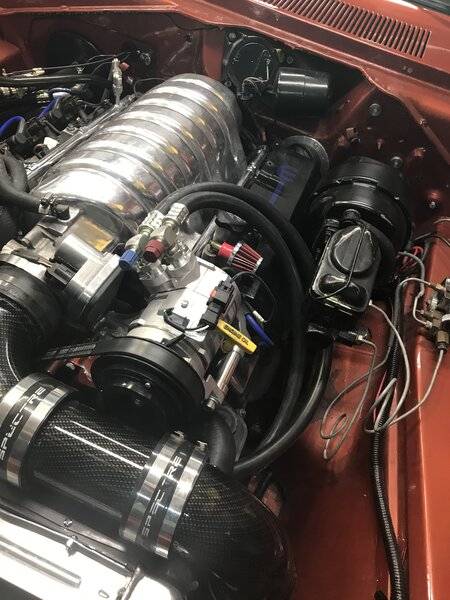

I am running driverside compressor. I used the factory heater hoses location and just made space for the ac lines on the opposite side. I used the bulkhead connectors and just put them in backwards to gain more clearance. Here are a few pictures. I am using the vintage air gen2 compact version in my build.
Wow, everyone has nice clean cars, lol. Slick looking setup. I kinda wish I would have gone with the car front cover that I originally had, but I really didn't feel like messing with the frame rail for the alternator clearance. The high mount A/C compressor setup isn't ideal and I'm not even sure my ModMan intake will work with it, so this could get interesting. I know as things sit now I'll have to modify my fuel rails to work. I have a crossover line that runs between the front side of each rails (I used blank rail sections and drilled them myself) and the compressor will run right into the front of them. I may go to a dead head style fuel system though and just cap the fronts. Might give me just enough room.
