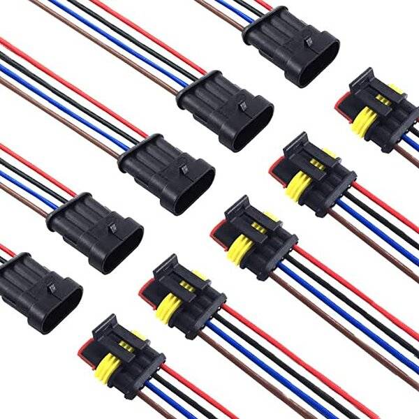

There are a bunch of GM style sealed multi pin connectors in different pin counts on Amazon that are pretty cheap if you want some
If you want to retain the ability to disconnect, yet still have a "solid" connection and don't care about factory crap, use something like this...
There are a bajillion configurations with number of pins and current carrying capacity.
