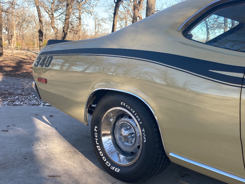

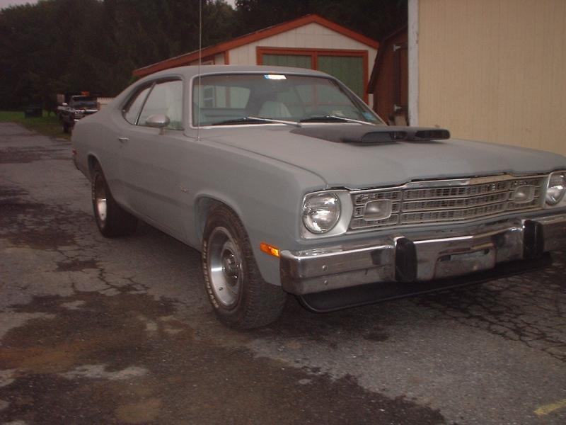

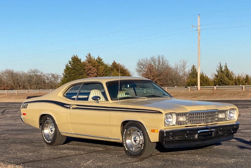

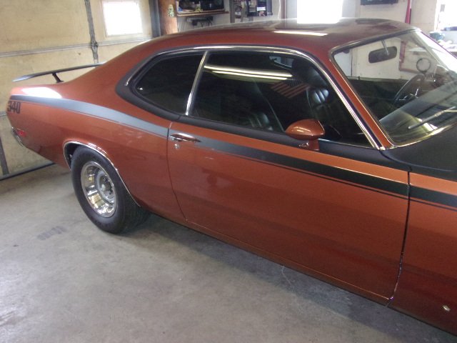

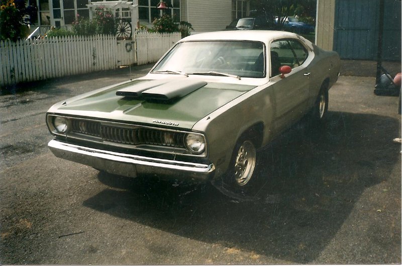

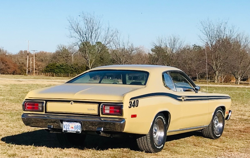

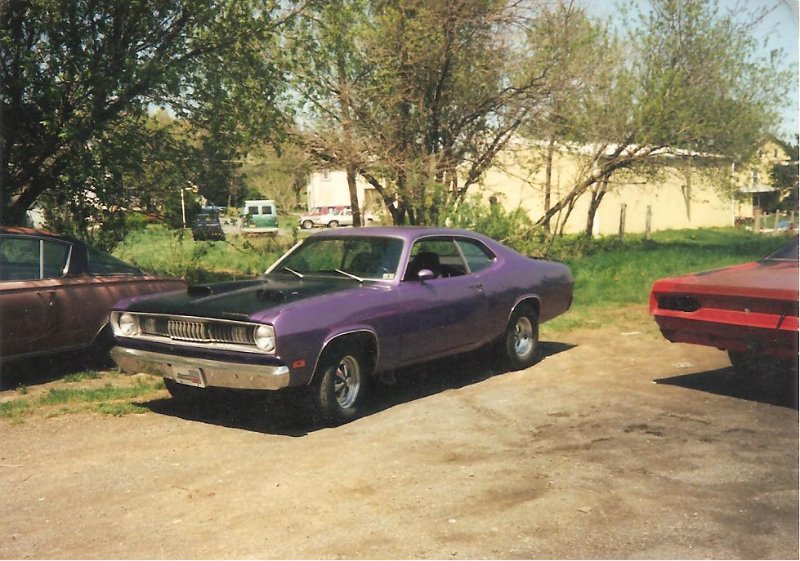

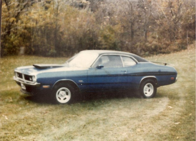

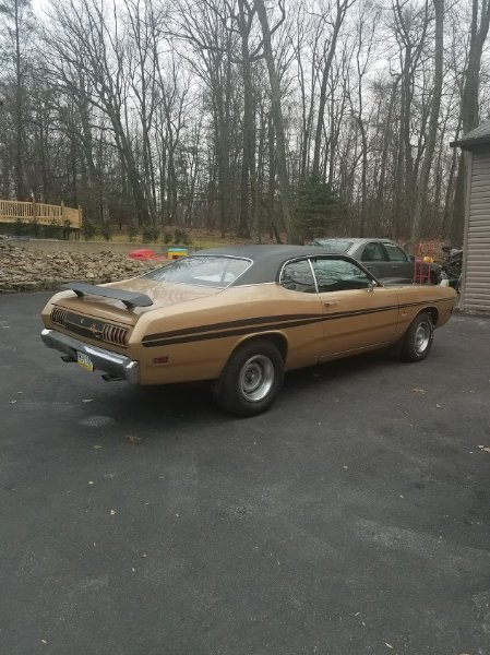

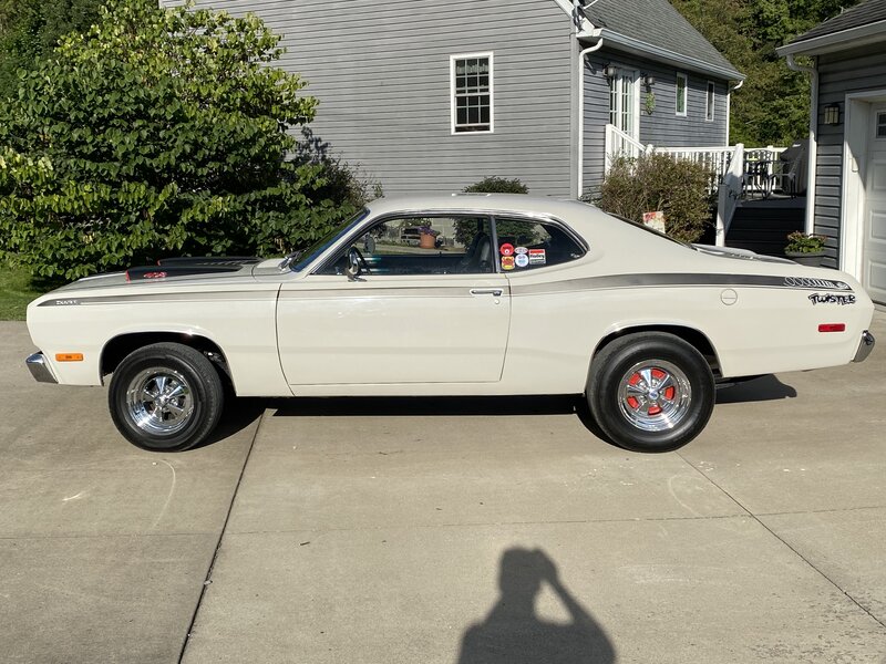

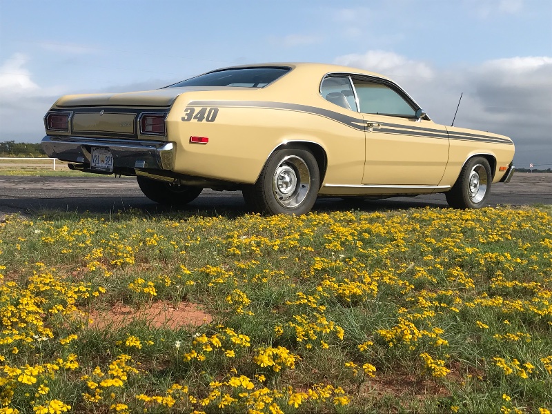

275's on all Dusters I owned. I could only post 10. 4 1/4 BS works best

Thanks for the info !!! Do any of these have an 8 1/4 rear like my 74? I'm thinking there is length difference between the 8 1/4 and 8 3/4 that the back spacing effects as well. Looks like your 1st pic is of a 73 with Cragars. Those 275's fit without spacers and longer studs?

I've never had issues with 275's on 8 3/4 rears and 4.25 backspace wheels but this 74 is a different animal. Like you said, this 74 has a good sized inside lip on the qtr. I know 275's won't clear the outer lip but what about the leaf springs from the inner perspective? Thanks !!

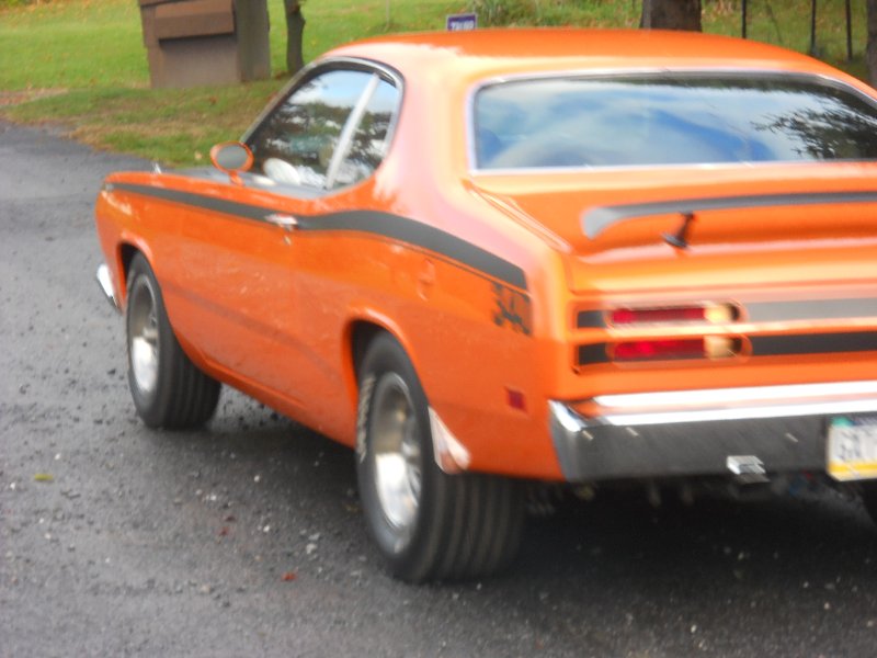

7th picture is a 8 1/4 that's a 74. Back space on those wheels are 4 1/2. The 8th picture orange Duster is an 8 3.4 with big bolt 4 1/2 axles. Those are big bolt wheels with 4 1/2 Back space. Same wheels as the gray 74. primered 71 with green hood has drag lights 4 1/2 back space big bolt wheels.

Based on your 7th pic with the same rear the 275's should work with the big bolt Cragars and 4.25 back space. I'm going to raise the rear so not worried about wheel lip but the tires need to have room by the springs and not rub. My 295 TA's with Nomad rims and 3.75 BS have about a 1/4 inch gap at the springs and will rub the lip if rear is too low. With the wide wheel lip I would expect 275's to rub at the wheel lip. I just don't want leaf spring rub.
