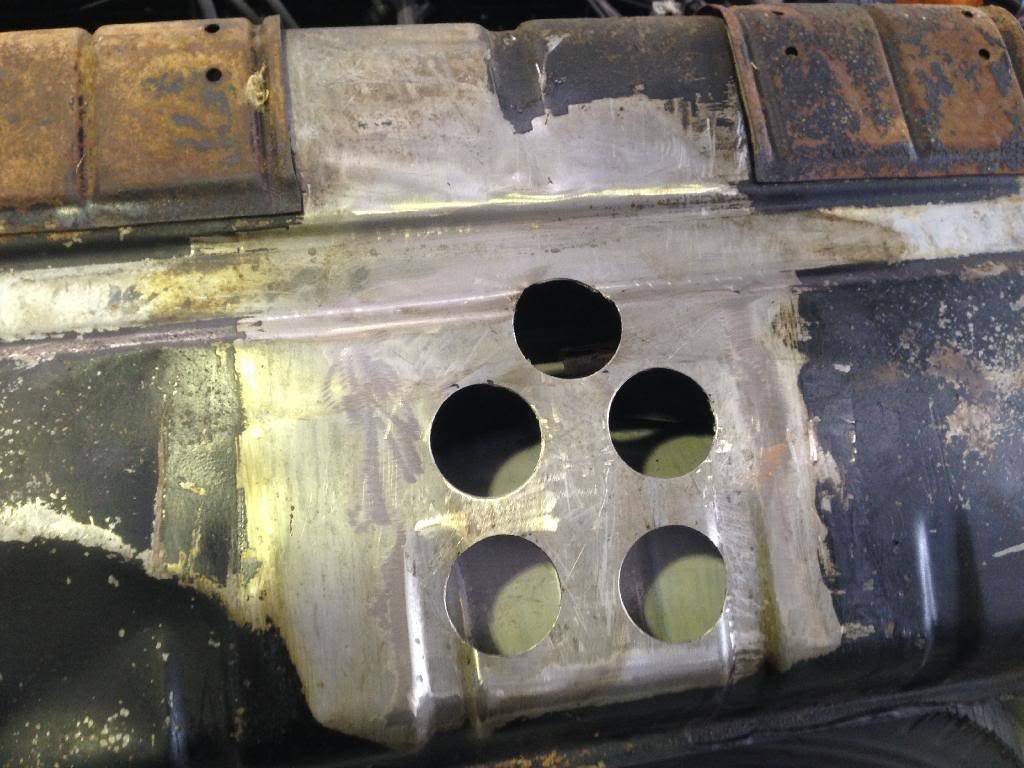

This week I'll cut my fuel tank up and add a sump and -10an pickups, hopefully get door glass and internals in too.

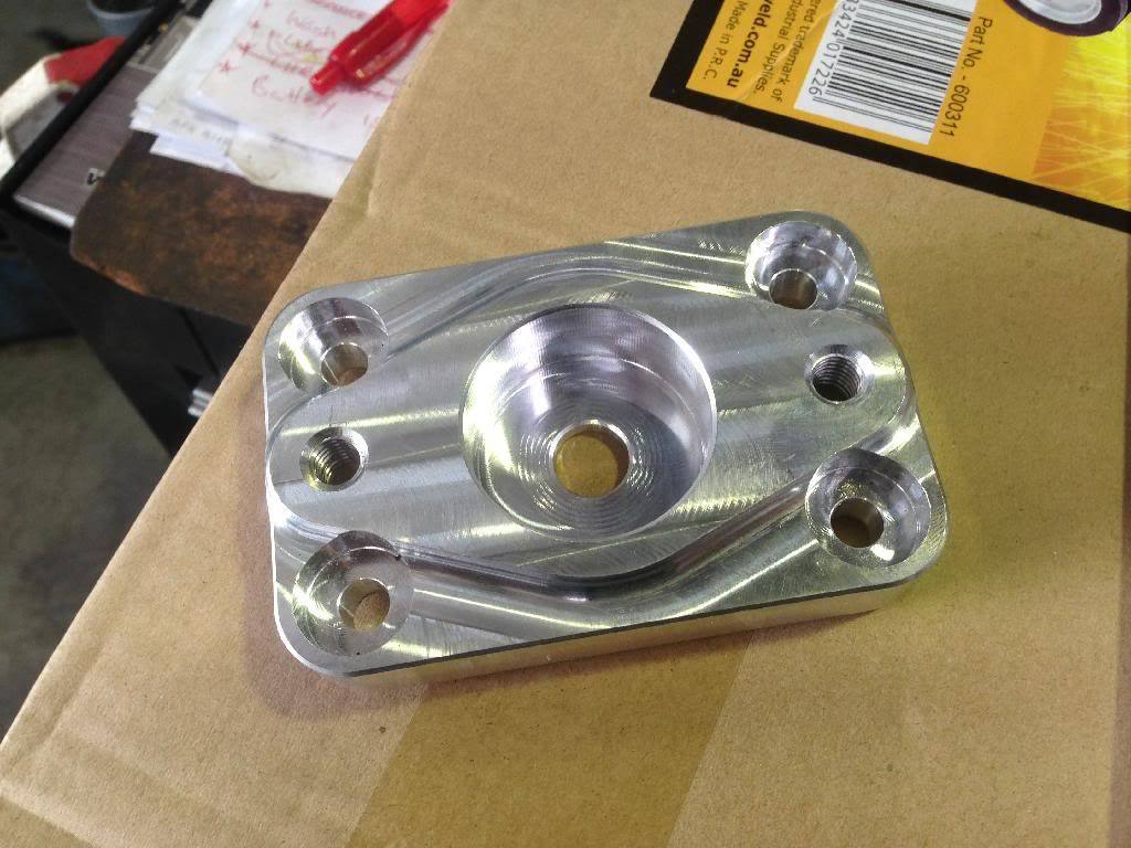

My wilwood master will be here tomorrow so I'll be busy making an adaptor for that. Also ordering my fuel tank sump so I'll get the tank ready for that... I wish my wheels would hurry up!!

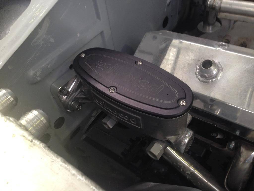

Got my master cylinder adaptor, can't recommend the piece enough, fits perfect and looks great. They are for sale on eBay.
Also bolted up the master cylinder, will be running brake lines soon

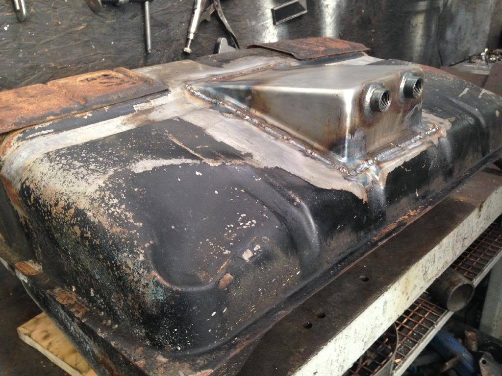

Also modified and fitted a sump to the stock tank, it will have a -10an feed from it (the other blanked off for now) and will be a -8an return fitted to the top. Pressure tested fine and will have a coat of paint before it goes in.
Also have to modify the tank strap as it won't fit now, will be a minor hurdle though
