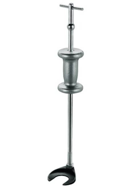

No Go..seized up!! Stuck like chuck..going for a puller...my stress level has to stay low..lol
Rear is under a car so striking angles are limited
I bought an adapter to go onto a slide hammer, it looks like an oversized harmonic balancer puller.

Must be twisted splines cause axle puller with 5lb.snatch handle wont budge it!!
Gonna try to rig up a 10lb. Dumbell for a snatch I need heavy duty shiiiiiit!!
