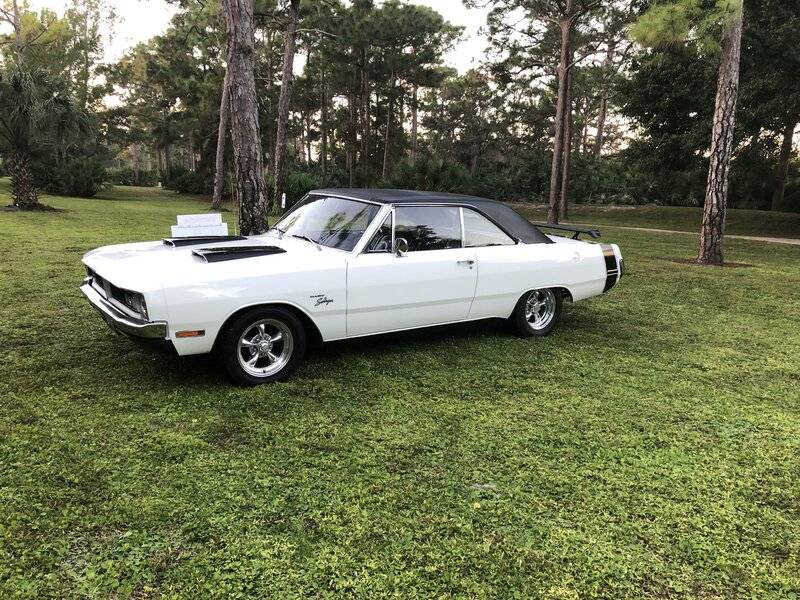

I have a 71 Dart Swinger with a 360, it was in storage for about a year without being started. I put a new battery in and cranked it over with the coil wire out to make sure I had oil pressure. It would run pouring some gas in the carb but wasn’t getting any fuel from tank. I put changed the oil, a new fuel pump, spark plugs and a gas filter and it started right up. At idle it seems to have a little miss but when I drop it in gear it really misses and shakes the whole car. Cap, rotor and wires are ordered and hopefully they will solve the problem. My question on the passenger side exhaust tip it blows warm to hot exhaust but on the drivers side the exhaust is cool and not even warm. Am I right in thinking my problem or miss is on the drivers side? Also I did fill up with fresh high test. Thank for any ideas with my problem

It ran fantastic, then life got it the way and it sat in a Florida garage untouched for 9 months to a year. When I pulled it out and tried to start it, I put fresh gas in it. Primed carb and started for a second and died. I determined fuel pump died so replaced it, put new gas filter and changed the oil. Turned the key and started right up but with a bad miss, I pulled the plugs and 6 were black with carbon and 2 were wet with gas not oil. Pulled the plug wires one at a time with it running and the second cylinder from the front on the passenger side made no difference in the motor and that was the plug that was wet.
I now thinking push rod, lifter or valve spring. Before I pull the valve covers I’m going to do the compression's test everyone is recommending. Engine only has 1800 miles on it
