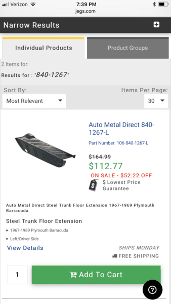

Found this, called summit, and got it for 111.17. Brought the pair down to $242.26
Sweet! I was going to make them. The tops are good, but the lower portions were poorly repaired by the P.O. With new amd quarters and rear valance, I had to get the right stuff.
So i guess your saying Summit has them on sale?? Any other parts like dual rear valance??
Jegs has the left side on sale for 112. I had summit price match because Jegs has the right side for 164 as opposed to summit’s 130 for either side. So summit beat the left side price, and I bought both sides from then. I bought the dual rear valance at full price.

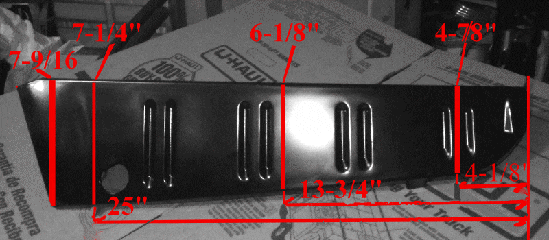

Some dimensions from a driver side repop and view from front if it helps............

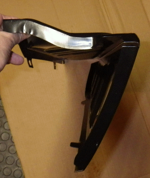

The ribs provide the stiffness as part of the unibody which you won't get with a flat piece but whatever floats your boat .I bought my dual valance and a rear cross member from an AMD vendor in Cali who was cheaper than AMD themselves and shipped free in the US .
The extensions were available local in $Cdn so I bought those and a complete trunk floor here .
I found and bought a pair of NOS before these were reproduced. AMD seams to have done a good job on these......
I have had Folks reach up and under for these tabs only to say they are original. Nice original Car.
I informed them afterwards they were replaced with AMD pieces much to their surprise. It does "matter" and Cookie pan sheets will not satisfy all.

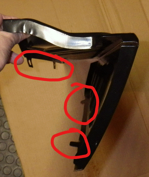

They could have put the rear wiring harness tabs on the left piece and may be doing that now. Mine were first releases and had to fab the tabs for the harness on the drivers side. I used band strapping that was heated to reduce the temper and coated in black platstic dip and sent them to Hodge for install.
